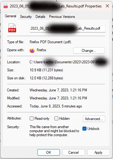

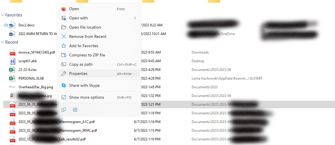

  1. Save the file to a local hard drive, network share, or cloud share like OneDrive.
  2. Open Windows File Explorer and go to the folder where you saved the file.
  3. Right-click the file and choose Properties from the context menu.
  4. At the bottom of the General tab, you should see a section for Security. Select the Unblock checkbox and select OK.

    Checking the Unblock checkbox always works for me. There is currently no setting to apply to all future downloads.
