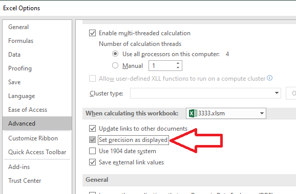

Andreas Killer 144.1K Reputation points Volunteer Moderator
2022-01-21T11:02:17+00:00
Damn, I've really made a fool of myself now. :-)
I was so focused on rounding the values and completely missed the essentials. Please forgive me, I am very sorry.
Most of the code below is designed to catch possible errors. The actual part that changes prices is not longer than your original code, but should run much more faster.
I wish you a nice weekend.
Andreas.

With Application
'Note:
' The Range.Find method also finds other currency codes with a $, e.g. € on a German system
' No need to use: CurrencyCode = .International(xlCurrencyCode)
CurrencyCode = "$"
.EnableEvents = False
SaveCalculation = .Calculation
.Calculation = xlCalculationManual
.ScreenUpdating = False
End With
With ActiveWorkbook
SavePrecisionAsDisplayed = .PrecisionAsDisplayed
.PrecisionAsDisplayed = True
End With

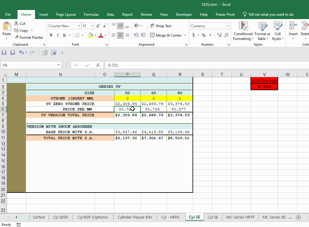

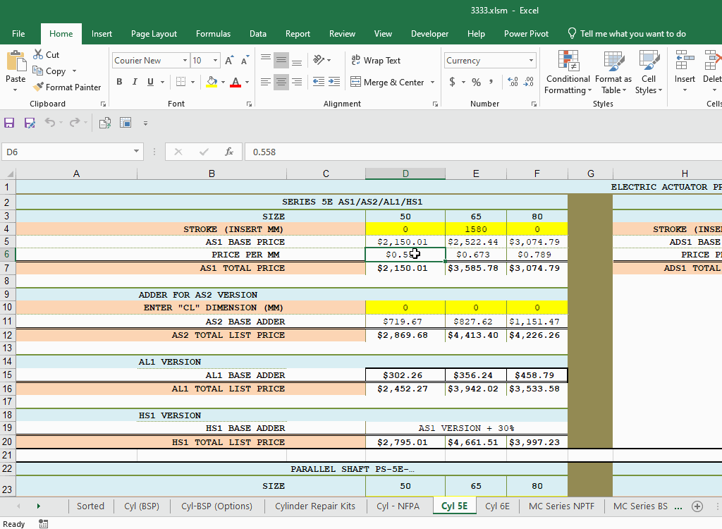

    2022-01-17T23:42:38+00:00
    I just sent you Excel file 2222.xlsm
    Please let me know whether or not you received it.
    You will see that 99% of the $ prices in the various tabs of the workbook have 2 decimals. But there are some exceptions:
    * Tab "Cyl (BSP)" row 319: $ prices have 4 decimals;
    * Tab "Cyl 5E" row 6: $ prices have 3 decimals;
    * Tab "Cyl 6E" cells I4-I9: $ prices have 3 decimals.
    * There probably are more examples that I am not aware of...
    The goal is to apply whatever % increase/decrease is specified in the box "pctChange" of each tab with exact rounding of each $ price based on the decimals.
