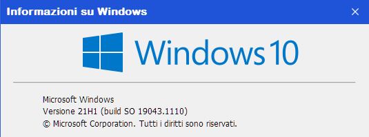

Hi, I'm back as promised, I found time this evening to repair W10 using the ESD-USB key, pepared yesterday by Media Creation Tool, X64 Italian version of course.
Following ur suggestions, I tried keeping my settings, performing a fresh install without loosing my personal files. More, I chose to install updates during the W10 install... this is the result I got :
Unbelievable, it was successful...
Many restarts, keeping my fingers crossed anytime, but... at the end all was running fine !
I lost some customizations, it doesn't matter, I will restore all thru a free utility I use since many years, that's Winaero tweaker, especially for font sizes... my eyes aren't working anymore as I was young ;-)
All programs and other small things are working.
I checked WU and it just dowloaded and correctly installed a NetFramework update only.
The funny thing is, there is no mention anywhere on WU about KB5005033 installed, I don't care, Winver version showed is .1165 finally. Looking at WU the 21H1 install date remains 2021 May 19th as it was before.
