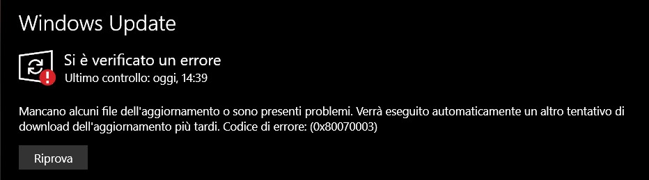

Windows 10 has pushed an update( KB5005033) for me that refuses to install. This is the error that I get:
Some update files are missing or have problems. We'll try to download the update again later. Error code: (0x80073712)

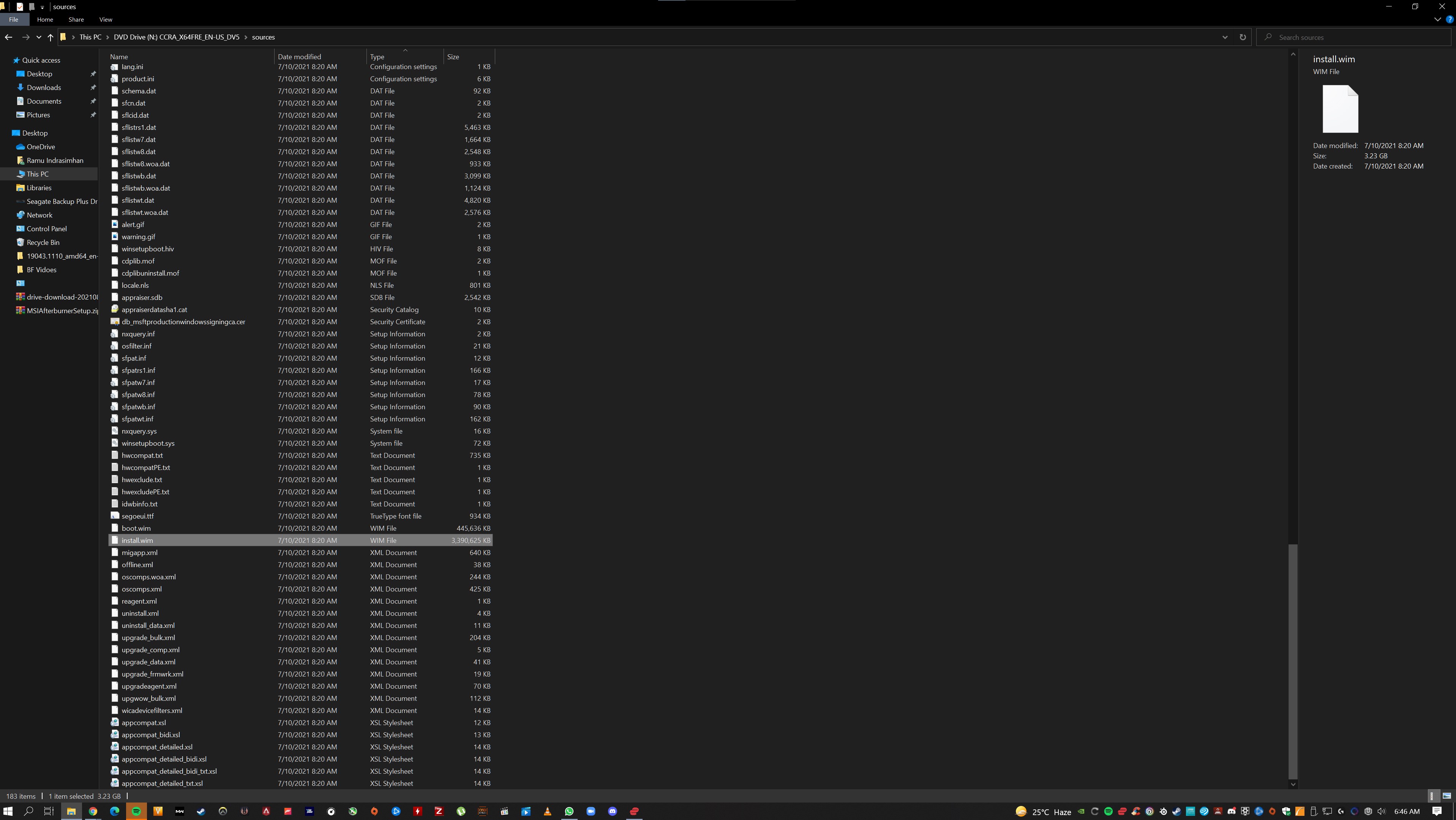

I have used a Windows10 ISO that I downloaded. It is the same exact version and build number of my current Windows 10 version.

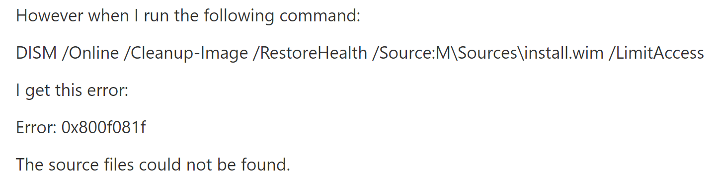

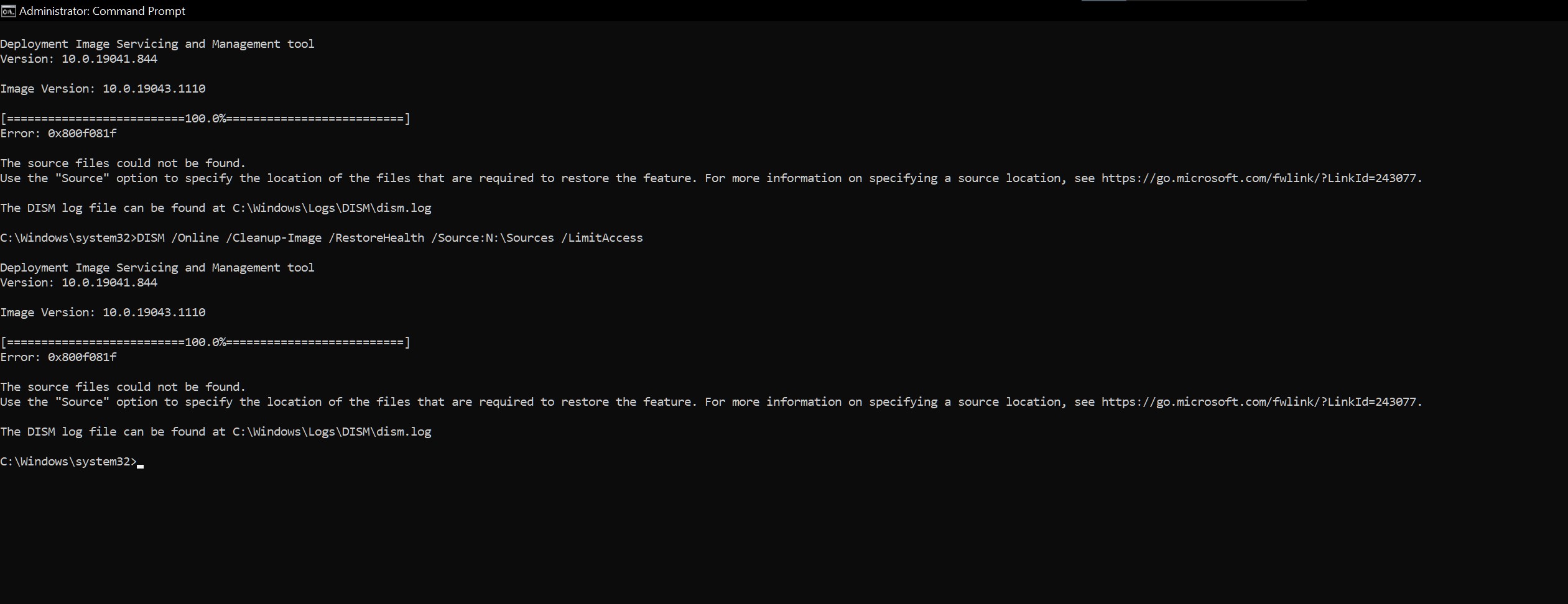

However when I run the following command:
DISM /Online /Cleanup-Image /RestoreHealth /Source:M\Sources\install.wim /LimitAccess
I get this error:
Error: 0x800f081f
The source files could not be found.
Use the "Source" option to specify the location of the files that are required to restore the feature. For more information on specifying a source location, see https://go.microsoft.com/fwlink/?LinkId=243077.
The DISM log file can be found at C:\Windows\Logs\DISM\dism.log

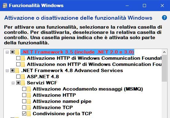

To try and repair this, I was told it could be an issue with .Net framework not being installed, so I used optional features to install that.

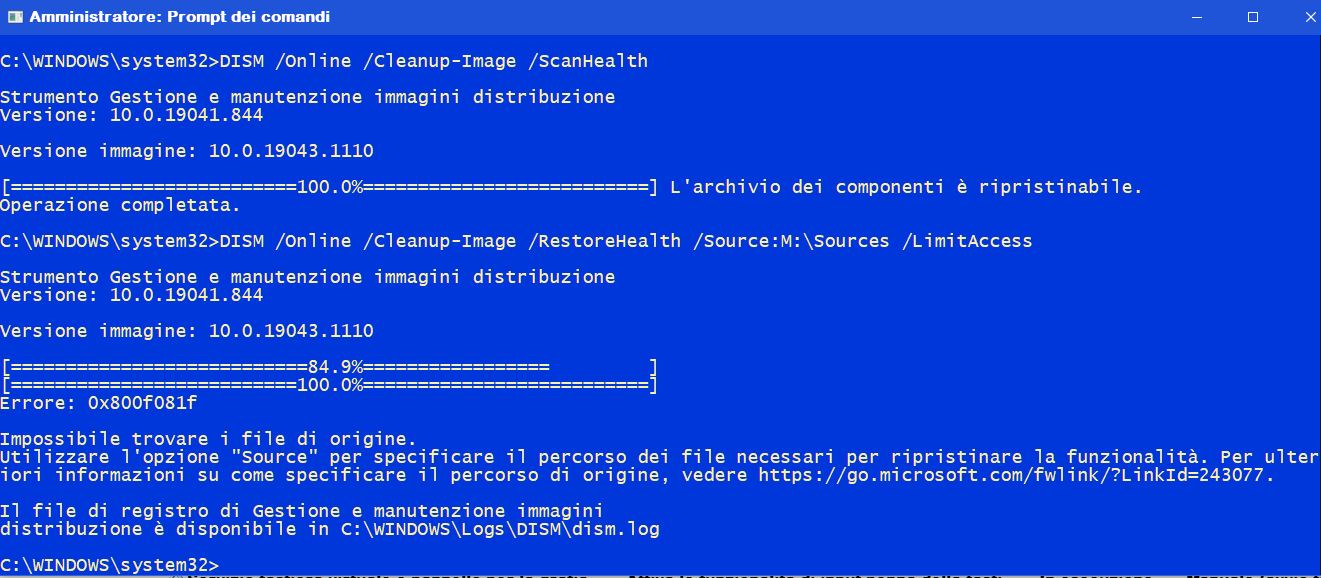

    Oh... thanks Jeremy, I downloaded and made a new USB 21H1 install key this afternoon thru a just downloaded MCT, that reports to be version 10.0.19041.572.
    Yes, I made a mistake, but there's a way to check exactly which version is on the ESD-USB key just created before trying to install ?
    In the Source folder, the Install.esd big file doesn't show any version, if I extract install.wim from it... no version as well.
    So, rewriting my question, my concern is : I have the 19043.1110 installed, if I try a new install using this key, assuming it will work... I will get 19043.xxx what ?
    So, you're right again, maybe better to wait a couple of months for 21H2 / 19044 in case, in the hope it will be released since Win11 is coming...

    Back to the point, concerning the Media Creation Tool, I did the same to upgrade from 20H2 to 21H1 using this way to safely update Win10 and it works.
    I was concerned to try again in these days, as I wrote before, the 21H1 downloadable version by MCT is the 10.0.19041.844 while the actual running version is 10.0.19043.1110 since impossible to set the 1165. I'm not sure if installing an outdated version on a newer one it will lead to get some mess...
