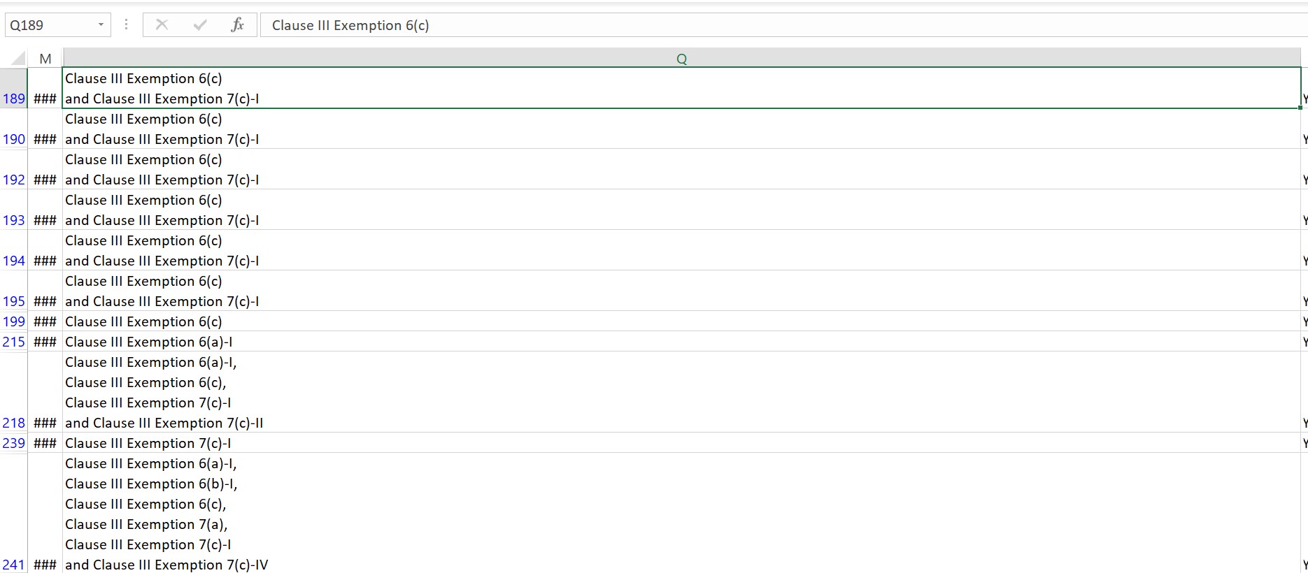

    First challenge is to populate the CSV data into the source workbook with line breaks. Once I have everything in place. I start to populate the template with a range of numbers instead of inputting one number at a time in the input box and saving it. (I will make sure that the data exist for those input numbers at least in one of the categories for Sheet3).
    Like I said before:

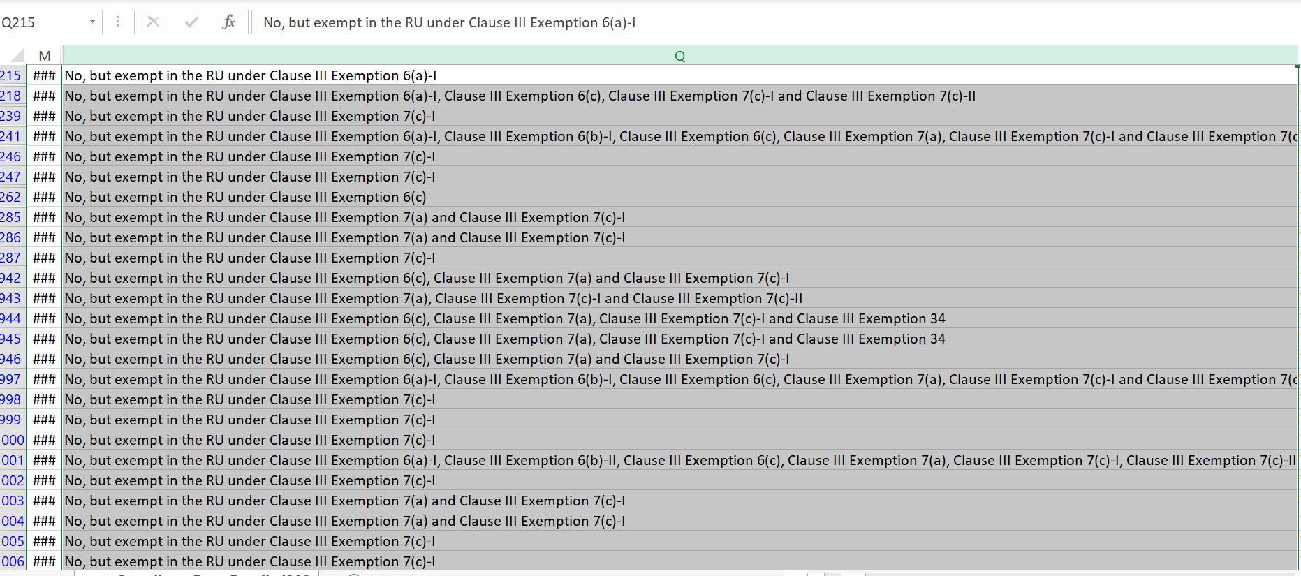

    I have a source workbook and one column into that source workbook comes form a CSV downloaded from the portal. That information from the CSV goes into the template's Column G:
    The data in CSV column Q for each unique numbers will be as shown in the screenshot below. The Column Q CSV entries go into template Column G via wsSource workbook.
    I am not able to share the workbook because I have not yet created wsSource with CSV Column Q data. It is hard to create line breaks for 800 unique numbers although a small percentage of rows does not require line breaks..
    Original CSV
    ![Image](https://learn-attachment.microsoft.com/api/attachments/260eb9f4-6d00-44c5-ae29-44133b6bf5b1?platform=QnA
    CSV after Line breaks
    After I copy that data from the portal CSV. I need to clean it up and add line breaks. The picture I shared before and the text did not match exactly because I took the example text directly from the portal and template has info relevant to other unique number. Roman numbers also exist in the CSV. e.g 7(c)-V
    "and" is already there in the CSV no need to add.
    In summary, I have to prepare wsSource workbook with additional row from CSV Column Q to populate the Sheet3. Thereafter, it is just as you written the code before for Sheet2 wsSource to wsOutput with filters.
  2. OssieMac 48,006 Reputation points Volunteer Moderator
    2021-03-12T02:03:16+00:00
    It is all too complex to be sure that I am interpreting correctly. I was hoping to get workbooks including the data so I could properly test.
    The following example code will convert the string data in column Q by removing the leading string and then adding Line Feeds where required. You will need to integrate with your existing code before copying to the Output sheet.
    If the leading words in the cells changes with different records then it will not work and it might be necessary to loop through the data and remove any text before the first occurrence of "Clause"
    The Find and Replace method is much faster than looping through the data and converting each cell.
    Code edited since initial posting to try to align to workbook and worksheet names used in previous examples.
    Sub Macro1()
    'This code run on source worksheet
    Dim wbSource As Workbook
    Dim wsFull As Worksheet
    Dim rngColQ As Range
    Set wbSource = Workbooks("ML.xlsx")
    Set wsFull = wbSource.Worksheets("Full-View")
    With wsFull
        ***'Following set for column Q of source data so edit Q if not correct.***
        Set rngColQ = .Range(.Cells(2, "Q"), .Cells(.Rows.Count, "Q").End(xlUp))
    End With
    With rngColQ
        ***'Delete the leading words no longer required***
        ***'(Code actually replaces the words with zero length string)***
        .Replace What:="No, but excluded in the RU under ", \_
                Replacement:="", \_
                LookAt:=xlPart, \_
                SearchOrder:=xlByRows, \_
                MatchCase:=False, \_
                SearchFormat:=False, \_
                ReplaceFormat:=False
         ***'Replace the comma with comma plus a Line feed***
        .Replace What:=", ", \_
                Replacement:="," & Chr(10), \_
                LookAt:=xlPart, \_
         ***'Replace " and" with a Line Feed plus "and"***
         ***'(Appears that there is no comma for last part***
         ***'so needs to be handled on the "and")***
        .Replace What:=" and", \_
                Replacement:=Chr(10) & "and", \_
                LookAt:=xlPart, \_
        .WrapText = True    ***'Turn on Wrap Text***
    End With
    End Sub
