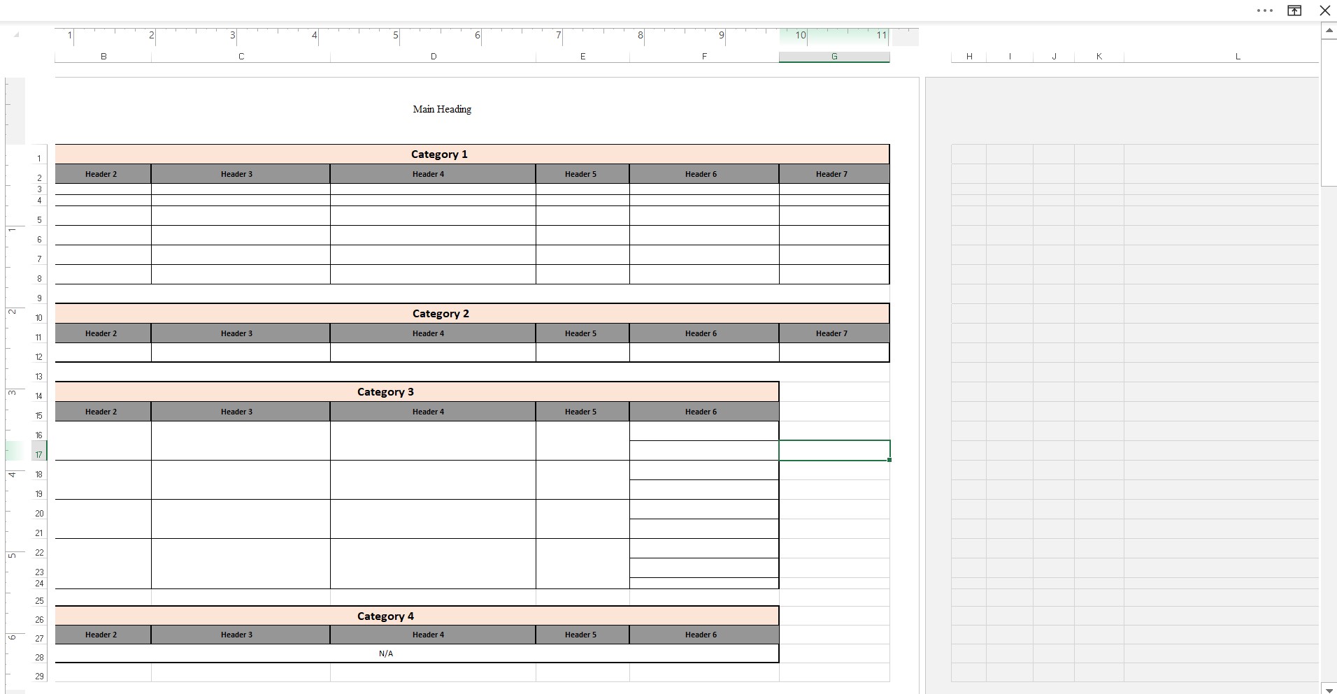

    I have another small task to do. The same code can be manipulated to the other sheet wsSource to wsOutput. But this time the range needs to be dynamic. Extra rows might be needed. It is a bit tricky.
    I can share the screenshots if you are okay with that. If not I can mark this question as solved.
    With wsOutput
        lngLastRow = LastRow(.Cells)
        With .Range(.Cells(2, "A"), .Cells(lngLastRow, "R"))
    With Selection
    .Borders(xlEdgeLeft).LineStyle = xlContinuous
    .Borders(xlEdgeTop).LineStyle = xlContinuous
    .Borders(xlEdgeBottom).LineStyle = xlContinuous

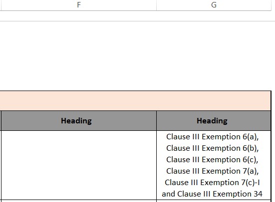

    Column A to Column F...
    Column G: No, but excluded in the RU under Clause III Exemption 6(a), Clause III Exemption 6(b), Clause III Exemption 6(c), Clause III Exemption 7(a), Clause III Exemption 7(c)-IV
    What I do is introduce line breaks from the word, Clause (everything in one cell) and remove other text.
    e.g Column G (after clean up)
    and Clause III Exemption 7(c)-I
    screenshot
    Q1) Is there a efficient way to do the above task for about 800 numbers.
    Now once I have the data transformation done for all the numbers.
    I want to populate it as I did before from wsSource to wsOutput in to the next sheet (sheet screenshot) but this time I plan to use the range of numbers directly (like an array) to pull in the data to the templates. I want to drop the input box feature because a separate workbook needs be created for each number nonetheless.
    In other words, my input data for wsSource is as below (I would select the range $A$2:$A50). I want the macro to run on all numbers and save as the wsOutput workbook with the respective unique number in Column A and description of the number Column B as the file name.
    e.g
    888890
    777890
    888909
    789078
    1234567T89
    1246557Y67
    etc
    The transformed CSV data has to go into Category 1 table (below screenshot) based on a filter e.g Category 1 in wsSource.
    Number of rows has to be dynamic depending on the output numbers.
    I plan to delete all the empty rows in the template and keep it as shown in Category 2 & 4, that way I don't have to worry about deleting the left out rows. For the sake of demonstration I left those blank rows.
    Same repeats for Category 2 with the same unique numbers, if at all there are any entries with Category 2 filter. If no entries macro would enter N/A (as shown in Category 4)
    The input numbers source is same as above
    e.g
    888890
    777890
    888909
    789078
    1234567T89
    1246557Y67
    etc
    In case of Category 3, with Category 3 filter applied, rows can be merged when they match. Row content matches until Column E and Column F values has to be left out in separate cells as shown in the screenshot.
    In the end for Category 4 with the same unique numbers, if at all there are any entries with Category 4 filter. Macro populates it. If no entries macro would enter N/A (as shown in Category 4)
    e.g
    888890
    777890
    888909
    789078
    1234567T89
    1246557Y67
    etc

    I don't really understand all of your last post. I am happy to continue assisting you but I need to be able to see the entire picture from start to end. ie. I need a copy of the initial data (if I am understanding correctly it is a csv file). I also need a dummy Output workbook with the data displayed as required before saving. If you have sensitive data in the workbook then replace with dummy data.
    In your previous post I can't reconcile the following with the screen shot.
    After inserting the line breaks, line 5 is prefixed with "and" and the end of line 5 is missing the last character ("V"). Is the "and" really required?
    Then your screen shot is changed from above. ("and" omitted from line 5 and line 6 introduced and prefixed with "and". Line 6 text not anywhere in the initial Column G value).
