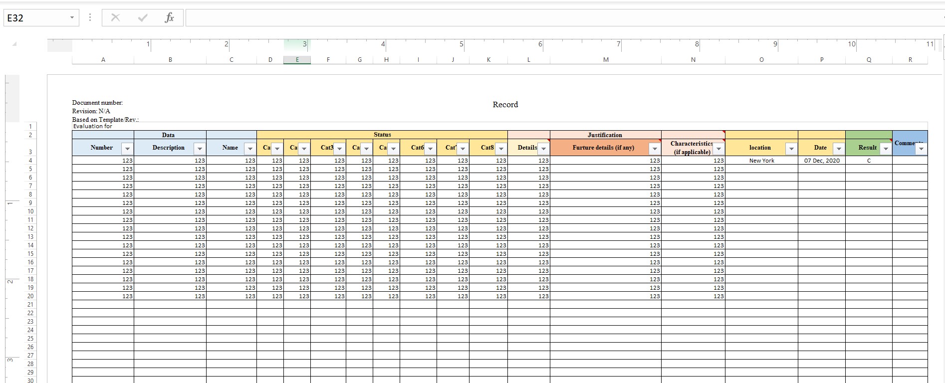

    Lastly, After copying it in to wsOutput sheet (see screenshot)
    I want to find the last row starting from A4 or N4 doesn't matter all have the same last row.
    Then For each cell in O4, P4 and Q4 to last row in the sheet
    I want to fill
    O4 to last row with "Location" (New York will be hardcoded in the code)
    P4 to last row with TodaysDate (06-Mar-2021)
    Q4 to last row with C
    and have all boarders only to the filled cells.

    In the meanwhile, I tried to address the code with the help of the recorder. But I was hoping, if I can use For Each, Next construct.
    However, I face issue with all boarders. The template I use has conditional formatting so if I use Clear instead of Clear.Contents conditional formatting is gone.
    Clear.contents leave the boarders and when I run the macro with a different input number now the boarders are beyond the last row.
