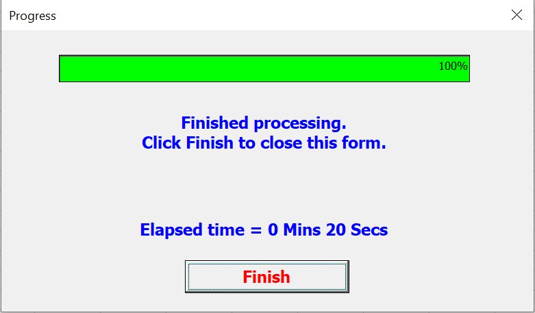

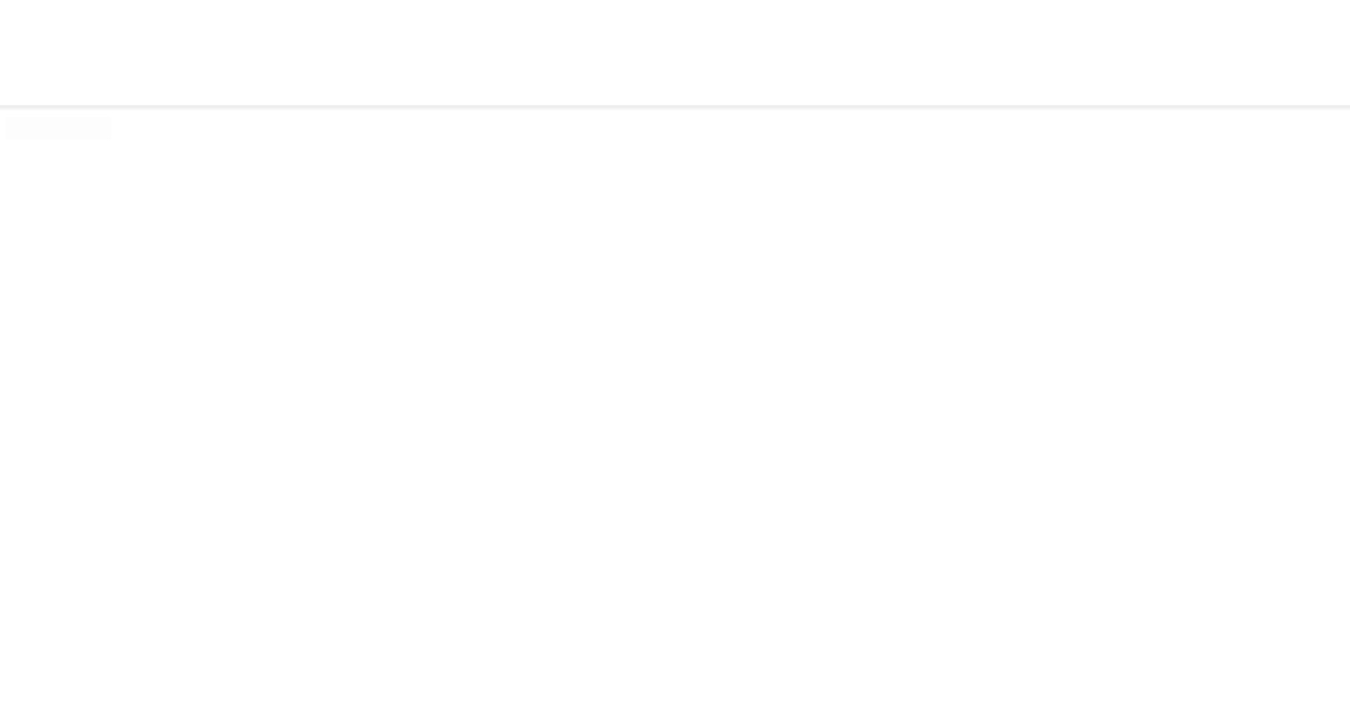

    When I assign user form macro to a button and run it I see a blank screen only after completion of the run I see the user form as below. Can't see the progress in real time. If I click on Macro sheet in taskbar during the run I can see real time progress when it switches back to wsSource during the run again I see blank screen how to make it stay on top until completion. This does not happen in Scenario 2
    Blank Screen
    User Form

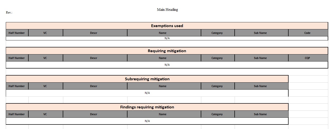

    I think I did not explain it clearly. The box heading won't be category 1 to 4 and column E will be just Category in the template like in the screenshot I posted earlier. Since you were looping through the Category numbers macro won't work if I change the heading names in the template.
    I was hoping you would hardcode the headings in the code so that I can change the code when there is a change to the template headings. They would be minor changes based on the revisions in future.
