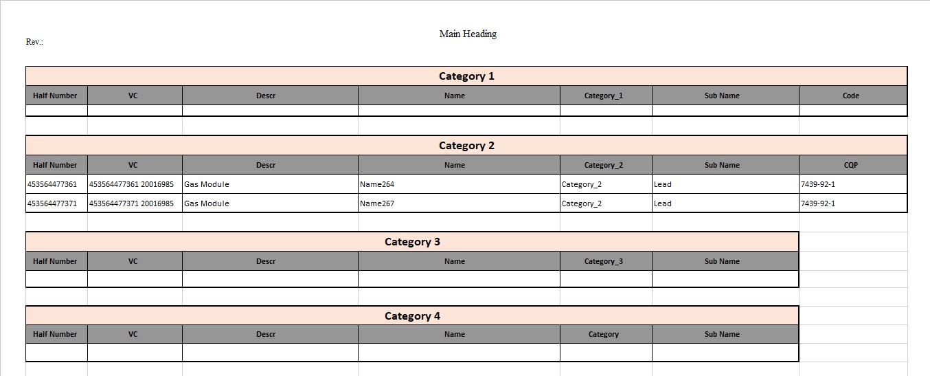

    Before N/A merge

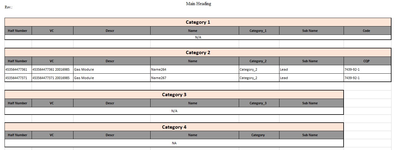

    After N/A merge

    In the Categories worksheets I have inserted N/A and merged the single blank row if no Category records exist.
