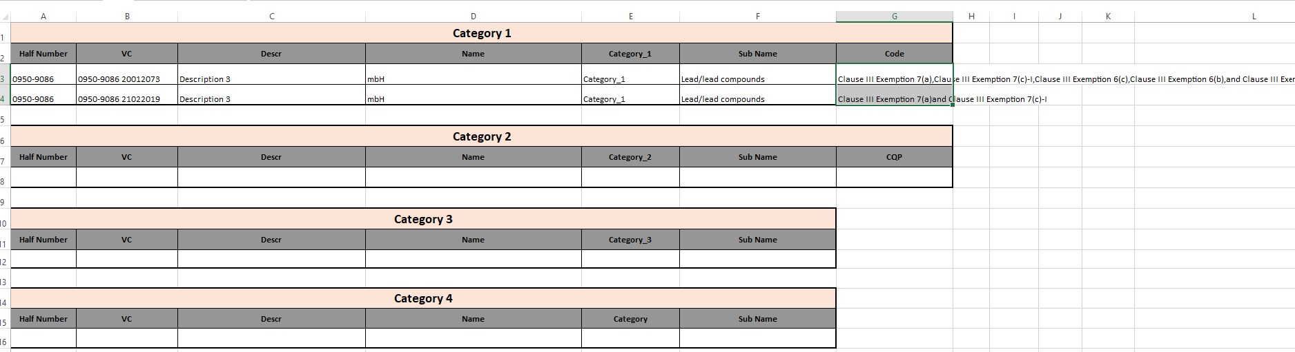

    In addition, to Unique number sheet the Categories worksheet should also be populated from the wsSource workbook for some unique numbers. It is like extending the earlier code further for the Categories worksheet. Workbook naming and all stays the same.
    Like I said out of 3000 unique numbers a small portion about 700-800 numbers have additional data for Categories_1,  Categories_2  and Categories_3. That data goes in to the Categories worksheet based on the respective filters.
    Some unique numbers might have data for any one or two Categories and no data for others then I include an N/A as shown in Categories_4.
    So in Scenario 2 I fill two sheets instead of just one for a range of unique numbers at a time and save it with Unique number and description.
    There is no need to insert rows for each of the categories. I am thinking that for Category 1 we simply copy the "Category 1" column headers and the data goes under it for whatever number of rows are required.
    I guess that would be much convenient to paste and format it afterwards accordingly rather than trying to fit into the template layout.

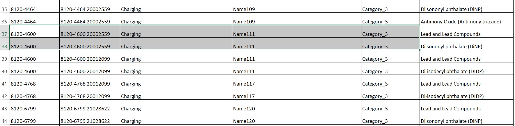

    Merge same cells as one from A:E for Category_3

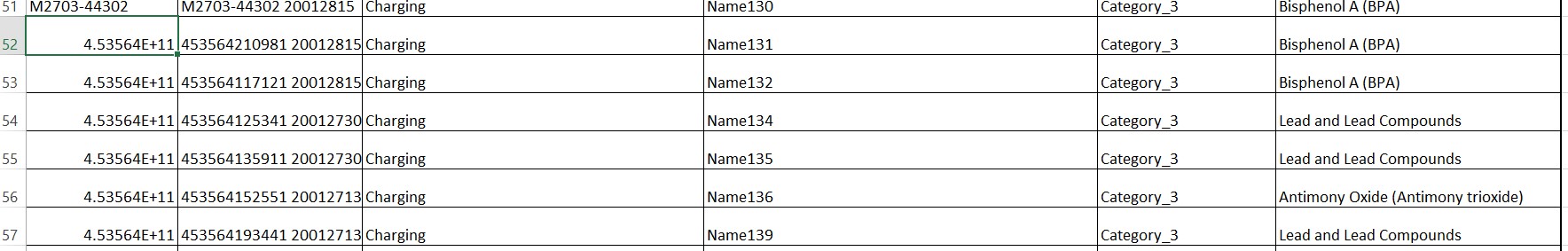

    Scientific number converted to number format. (maybe we can format the template cells to number format or better format the numbers after populating them)

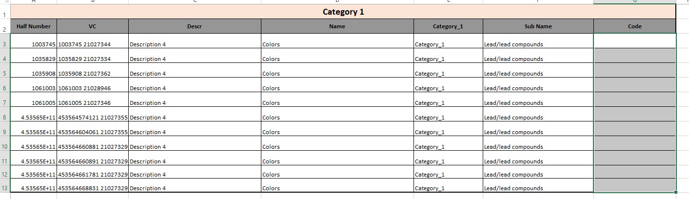

    Go to A1 cell  instead of leaving it as whole selection. I wanted to mention this in Scenario 1 as well.
    merge cells and N/A if no data exist as shown for Category_4 in the template

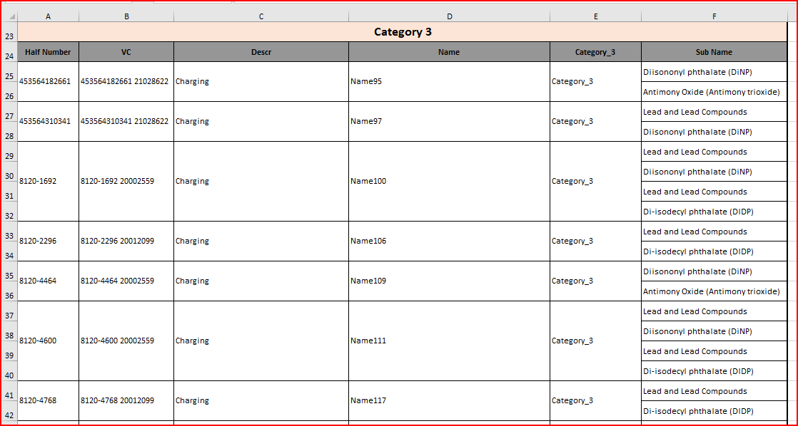

    Please confirm if this screen shot what you mean. If not correct then please provide a screen shot of what is required. I will look into the other problems.
