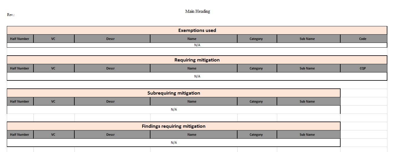

    For the Scenario 2 I want to make a variant that variant version will be used in particular cases. I attempted to do it but I am facing some difficulty in framing the code because it requires loop within a loop within a loop. May be there is a better way to do it.
    What I am trying to do is after I paste a set of Unique numbers with out duplicates in the unique sheet.
    The Unique numbers can also be taken from the excel by uploading the file.
    See e.g. I want to loop through the unique numbers based on the Column B. It would loop through all AMN1 unique numbers and look in wsSource and loop though the rows and populate the rows in the template and save. Loop continues for column B until AMN4.
    AMN1 to AMN4 can be named in any format we want. Those characters are only to separate the set of unique numbers that goes into the template.
    The new addition in the template is it would also capture the unique numbers as well this time in the template. So there will be a new column before VC number in the output sheet and before Half Number in categories sheet.

    2021-04-07T07:32:20+00:00
    I think I did not explain it clearly. The box heading won't be category 1 to 4 and column E will be just Category in the template like in the screenshot I posted earlier. Since you were looping through the Category numbers macro won't work if I change the heading names in the template.
    I was hoping you would hardcode the headings in the code so that I can change the code when there is a change to the template headings. They would be minor changes based on the revisions in future.
    I did not expect you would make use of those numbers to loop.
