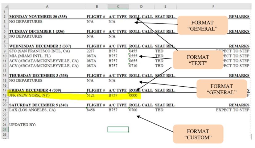

    I know it's been complicated, all this just to get in 0000 into a cell, and that is only used if there is a flight leaving at midnight. Everything works fine otherwise. I thought you may have seen the earlier macros. There are certain macros that need to be accomplished before others. Below is what my macros are doing (below image), there are a couple more which are not listed on here but they shouldn't affect what we are trying to achieve. They are all in the Module found on the link I provided. What you see in bold are when the format changes from General to Custom. What is in italics is area we are making are efforts on.
    I've attached another image of what I'm trying to achieve. The "0000" indicates midnight. That was in a "General" format, and I had to change the  format to "Text"  manually to take "0000". The other cells that are blank in Column D are fine for there are no flights, (they are also in the General Format). Maybe just another code to change Column D to Text and then insert "0000" into Column D if that cell is blank and there is anything other than a blank or "N/A" in the same row for Column C. This means I keep all my current macros, but it may be the best option with one we have been through.
    Thank you.

    2020-12-01T03:45:09+00:00
    So I gather what may be the best approach is use the text code formula early on for the time, then at the end after my subtractions etc. convert it to the end time where this 0000 can more easily be obtained? What about if I just add another macro where it will look for the blanks in Column D, but only add the "0000" if there is data on the same row for Column C that is not "N/A". So if Column C is blank or has "N/A" then the corresponding row in Column D is left blank.
