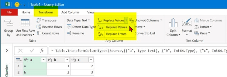

    Note: "Find and Replace" is "hidden" in PowerQuery under a different name (thanks for nothing MS!)
    Transform tab > Any Column group > Replace Values drop down > Replace Values or Replace Errors.

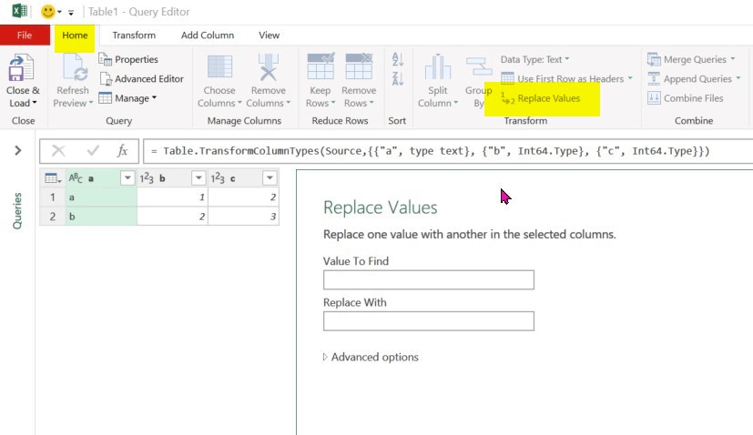

    oops, I just found another place to access "Find and Replace" I don't know if there is any functional difference between the two (I suspect they are the same):
    Home tab > Transform group > Replace Values button
