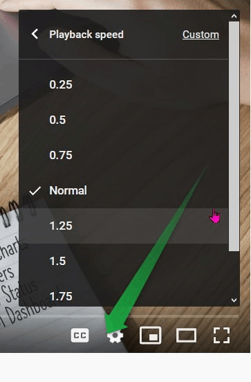

    Click on the 'Gear", then select Playback speed and pick a speed.
