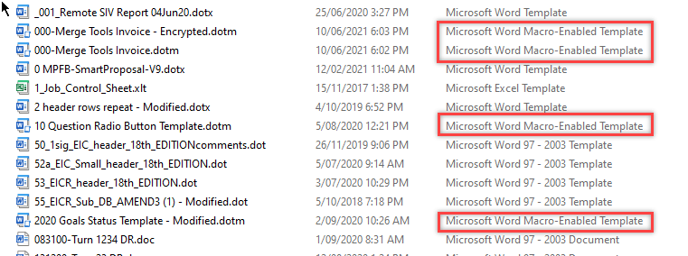

All templates are just opening as .dotm instead of .docm or .docx. Any other troubleshooting steps available?

However, unfortunately, I do not think that setting that folder as a Trusted Location will have any impact on the issue that you have that the files with a .dotm file extension are, for some reason, not being recognised by your system as Microsoft Word Macro-Enabled Templates as would normally be the case.

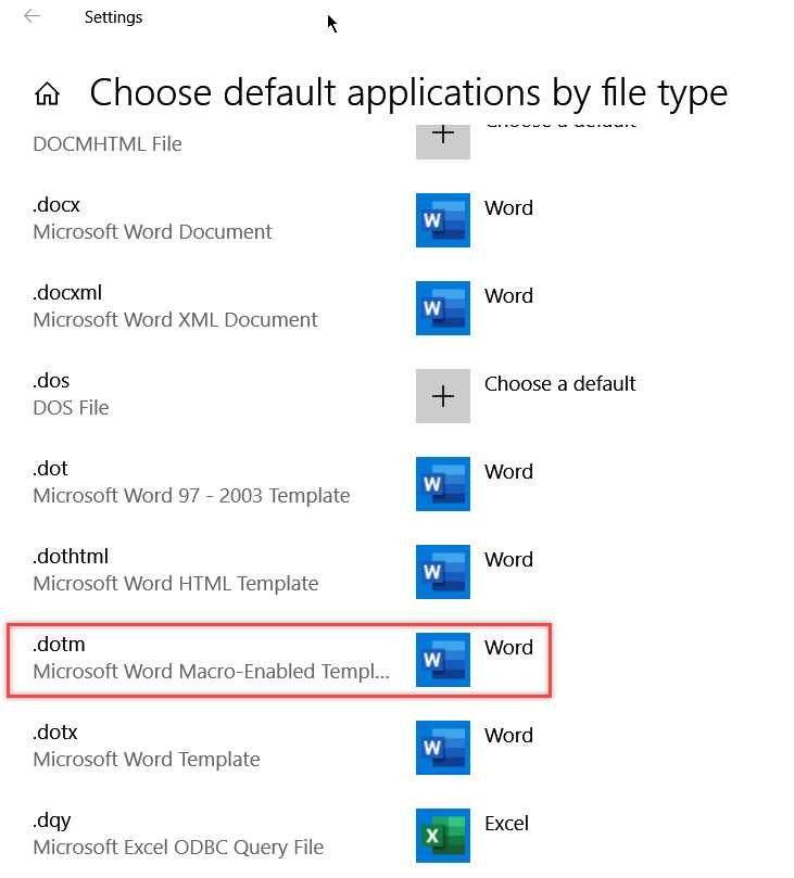

If you go to the Windows Start and click on Settings and then on Apps and on the left hand side, click on Default apps and then scroll down to the Choose default applications by file type, and scroll down throug the list of file extensions, do you see the dotm item as shown below?
If not click on back (the arrow at the top left of the screen) and then on Default apps again and this time scroll down to, and click on the Reset button under Reset to the Microsoft recommended defaults and see if that then causes the .dotm item to appear as shown above when you click on the Choose default applications by file type.
