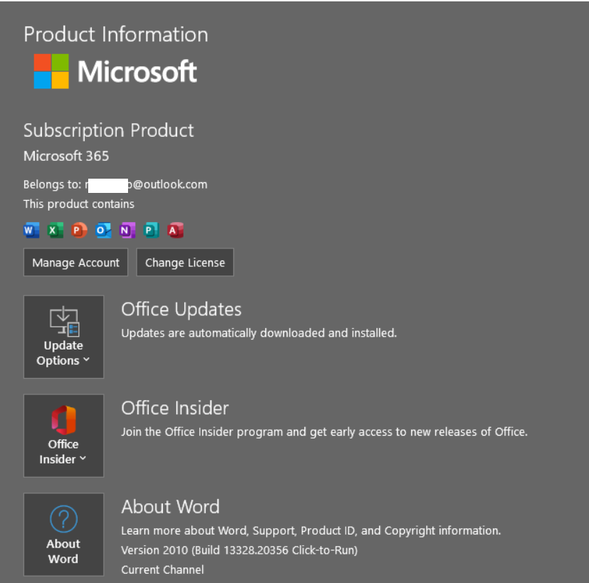

I've seen this issue written about and have tried the suggested solutions without luck.  First tried quick repair and then full reinstall of office 365. Also set related registry entries to "new."
All templates are just opening as .dotm instead of .docm or .docx.  Any other troubleshooting steps available?
