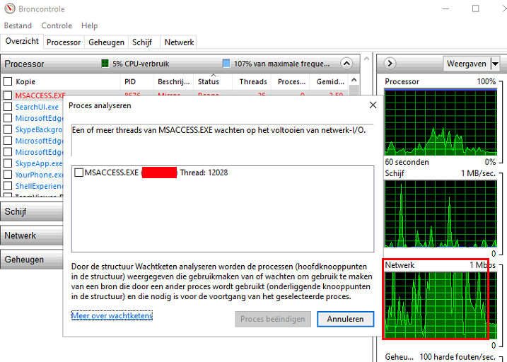

Since the latest Office 365 Update (June update) a returning error emerges when opening (larger) forms in MSACCESS.
Using the Access runtime (2013 tested on) instead of the full Office365 Access seems to solve this problem for now.
Here is a summary of the error, below I added a screenshot of the event viewer error log (it is in dutch though):
Faulting application name: MSACCESS>EXE, version: 16.0.12827.20268
Faulting module name: ntdll.dll, version: 10.0.18362.815
Exception code: 0xc0000374
Fault offset: 0x000dfa1d
Faulting process id: 0x1f30
