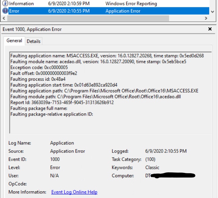

Here is a summary of the error, below I added a screenshot of the event viewer error log (it is in dutch though):
Faulting application name: MSACCESS>EXE, version: 16.0.12827.20268
Faulting module name: ntdll.dll, version: 10.0.18362.815
Exception code: 0xc0000374
Fault offset: 0x000dfa1d
Faulting process id: 0x1f30

Thank you for your feedback. Very soon, we will ship a new data type, known as Date & Time Extended, which enhances syntax compatibility with SQL while increasing accuracy & level of detail in date & time records.
While the feature is not yet enabled in Current Channel builds, most of the code for the feature is in the product in an inactive state. Nonetheless, we are aware of a problem that currently exists with this new code. As of today, if you are on version 2005, build 12827.20010 or greater, and you manipulate Decimal fields (Access DataType=Number/FieldSize=Decimal, or SQL DataType=Decimal) using DAO (Data Access Objects), you might have identified your app crashing. If you hover a variable with the type in VBA code, you may see that the field is not being displayed properly; either reading as ‘?????’ or giving a Type Mismatch error, or Access may crash.
We are very sorry for the inconvenience this causes in your Access app. The Access team is working on resolving this issue as soon as possible, and we will report back to you once this error has been fixed. In the interim, we’d recommend for you to roll back to a previous version (https://support.microsoft.com/en-us/help/2770432/how-to-revert-to-an-earlier-version-of-office-2013-or-office-2016-clic), or switch to a slower channel (e.g Monthly Enterprise Channel, or SemiAnnual Channel), until the issue is fixed in Current Channel.  The issue only impacts Decimal types so if avoiding DAO code that manipulates Decimal types is possible, we’d advise this as a short term solution.

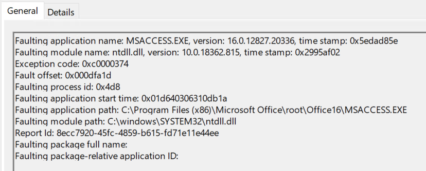

    I started putting this on another thread but I think it belongs here.  We are experiencing the issue with Access crashing too. But we only have a couple tables in our db that use decimal and they are not referenced anywhere in the steps that cause it to crash. Also, the crash is truly intermittent. Sometimes Access behaves exactly as it always has. And sometimes it vaporizes after opening a form from our app's opening form. Maybe 1 time in 3 or 4 it switches the cursor to an arrow with an hourglass and crashes. The rest of the time the form works fine. If it works then the whole app seems to behave, that is, I can't get it to crash after successfully opening a form from the opening form. But sometimes clicking a button to open a form immediately after opening the app shuts it down. Tracing the VBA code, it makes it through the On Load just fine before it crashes.
    Even though I doubted the decimal problem was the culprit, I decided to see if I was lucky when I had no logical explanation for a random shutdown and I updated to the new Access version 2005, build 12827.20470 ctr. It did not change my situation. I've decompiled and repair/compacted and recompiled. Still randomly flaky. One of my users has some critical weekly reports to generate but for him, attempting to open any of the forms used to launch reports crashes has copy. (Each user has a copy of the frontend on their machine.)
    After opening it and a form 15 or so times and getting 5 crashes, I looked in the event viewer and found 5 application errors.  They all read like...
    Faulting application name: MSACCESS.EXE, version: 16.0.12827.20470, time stamp: 0x5ef2a45e
    Faulting module name: ntdll.dll, version: 10.0.18362.815, time stamp: 0xb29ecf52
    Fault offset: 0x00000000000f9229
    Faulting process id: 0x3ae4
    Faulting application start time: 0x01d64ee426ad18fe
    Faulting application path: C:\Program Files\Microsoft Office\root\Office16\MSACCESS.EXE
    Faulting module path: C:\WINDOWS\SYSTEM32\ntdll.dll
    Report Id: 141a0658-0ecf-451f-b214-9d6999ac7855
    Faulting package full name:
    Faulting package-relative application ID:
    Log Name: Application
    Source: Application Error, Logged: 6/30/2020 8:41:32 AM
    Event ID: 1000, Task Category: (100)
    Level: Error, Keywords: Classic
