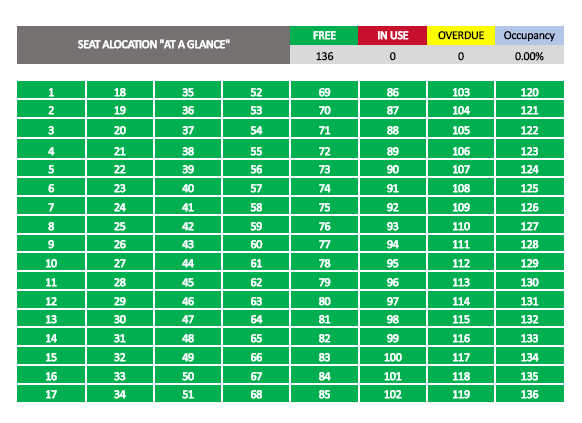

1- Before the start
The SCAN sheet will look like this, The scanner will be focused on cell C3 Named range ScanID

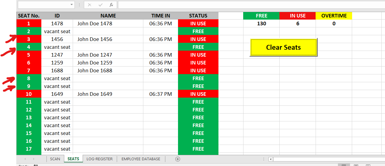

2- After the first 10 scan (employees)
After the first 10 scan (employees) on each sheet
RECORD/TRACKING before any check-out.
3- After some of the staff check out
Conditional Formatting is applied to cells
the ones in Yellow shows those who are taking more than 30 min in their lunchtime and obviously haven't been checked out.
Hope this helps

    2020-05-05T16:55:59+00:00
    Hi again Jeovany!
    I have a couple questions.
    We tested the excel today in the cafeteria and we encountered a couple situations and I wanted to tell you so you may guide us.
    We are using two computers with two RFID scanners.
    At some point, the following happened:
    1. The box with all the seat allocation stopped refreshing. So even if there was nobody in the seat, it was red. However, the assignment was still working fine.

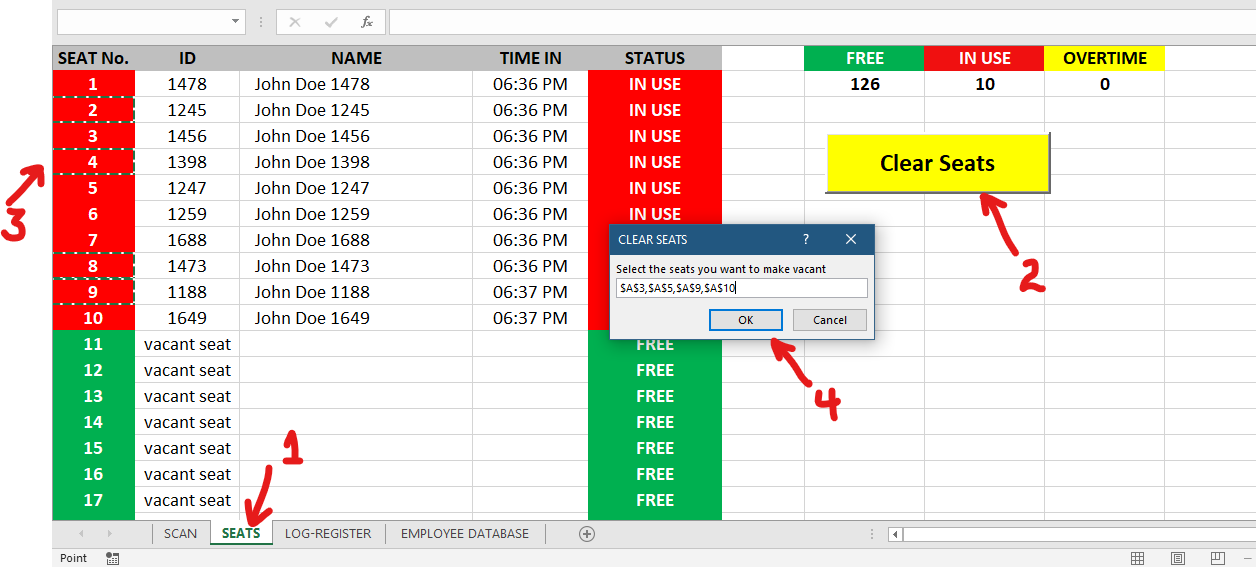

    2020-05-07T18:09:14+00:00
    Hi Debbie
    Find in the link below the file with the update according to your last requirement.
    https://1drv.ms/x/s!AjGRD1TlwpAGlniwIxOU1dlDFhbK?e=40IeJZ
    re:*"...*is there any way to auto clear the spaces if people forget to punch out?..."
    Please, follow the steps in the picture
    3- To select multiple cells (seats) in column A press and hold CTRL key
    AFTER
    The workbook before it close will perform a macro to clear and update the data entry in the file
    On the Log sheet It loops thru all ID and those who DID NOT PUNCH OUT at the lunchtime will be marked
    I hope this helps you
    Regards
    Jeovany
