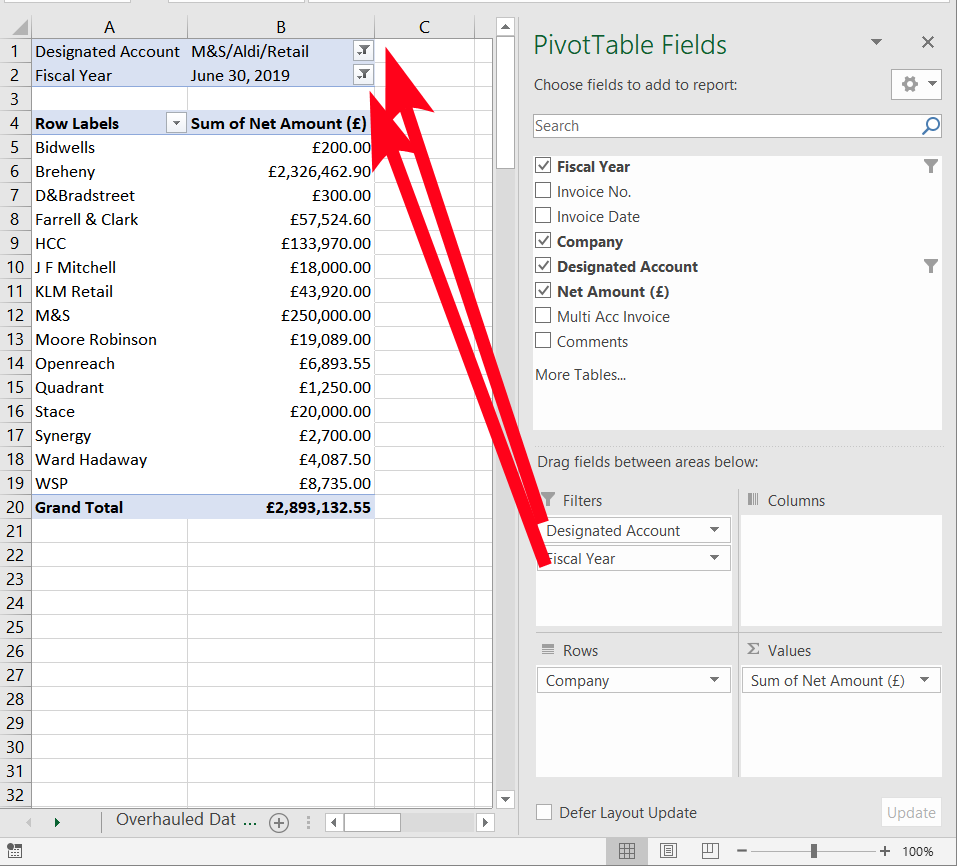

Data entry is somewhat similar, but you need a separate row for each account type. This is a better format, actually the required format, for creating a pivot table.
D'oh! (head smack!) My mistake. I should have done this too (thanks for the reminder and inspiration Jeovany!) ...  So here is what his better formatted data looks like in a pivot
No spaces!
Notice that I put the "Designated Account" and "Fiscal Year" columns into the "Filter" area. This added the option to filter the pivot table in the upper right corner of the pivot. So you can filter by the specific account you wanted, and I picked one year, but if you need, you could also select all years.
I think this new pivot gives  you what you need.
(Yes, I am pivot crazy.)
Here is another example using the same pivot. I've filtered for "All" accounts to and one specific year, 2017. It includes a total for all accounts that year
