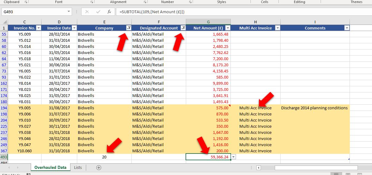

Interesting. You were able to do it all in a Table.
I see you cleaned up his company data.
I would do 2 tweaks to your layout.
First I would put all the slicers at the top of sheet, ie move the "Fiscal year" slicer
Second, I would add a "Company" slicer.
Questions:
#1. what is the "Multi Acc Invoice"? Where did this column come from? I think I see it now, but is it really necessary?
#2. Why do some rows have various styles applied to them?
#3. Why the unreadable text color for most of the Fiscal year entries?

D'oh! (head smack!) My mistake. I should have done this too (thanks for the reminder and inspiration Jeovany!) ...  So here is what his better formatted data looks like in a pivot
No spaces!
Notice that I put the "Designated Account" and "Fiscal Year" columns into the "Filter" area. This added the option to filter the pivot table in the upper right corner of the pivot. So you can filter by the specific account you wanted, and I picked one year, but if you need, you could also select all years.
I think this new pivot gives  you what you need.
(Yes, I am pivot crazy.)
Here is another example using the same pivot. I've filtered for "All" accounts to and one specific year, 2017. It includes a total for all accounts that year
Here is a link to my tweak of Jeovany's file
https://1drv.ms/x/s!Am8lVyUzjKfpoCf8_-gzab5ruAz0?e=xk0cgJ

    #3
    The company name drop down only works on the "All Data" tab.  I just tried it works as advertised for me. I click on the drop down arrow, pick a new name it shows in the cell. Have you downloaded the file or are you trying it from OneDrive (I haven't tested that).
    #4
    Remove the "Sum of Totals" from the Sum Value area of the pane.
    #5
    The "Drill Down", sheet 1.
    As far as I know, no, these drill downs do not link back. You have to regenerate them to reflect changes.
    Actually, it is simple enough for you to test:
    • Create a drill down
    • Just delete a row from "All Data" tab
    • refresh the pivot, you'll see the changed value
    • Create a new drill down, you'll see it no longer shows the deleted row, while the original one still has the deleted row
    If you right click in generated drill down sheet, you'll see that the "refresh" option is disabled.  Linking back is a "missing feature".  So is the useless name.

    Jeovany and I have both pointed out that you are going to have to clean up the company names used. Any time you see 2 entries in the Company Slicer, there is a problem with the company names. Most likely problem one or more spaces at the end of the company name.   Simple fix, insert a new temp column, copy the company names using the =trim() function.  Enter the function, click in the company name column, close the parenthesis and hit enter in the first row of the table, it will automatically be copied down to the rest of the cells. That is one of the automation features of Tables. Then copy the new column, paste special > values to the original column and delete the temp column.
    #1
    No, you have to right click and select delete.  I checked, having a blank row in the table does not cause problems.
    #2
    Sorry, not that I know of.
    #3
    The lists tab contains the unique list of company names for the drop down on the input.  I forgot to mention it. When you enter the company column, look for a drop down arrow displayed on the right side of the cell.
    #4
    It's real easy. That is the beauty of the PivotTables. Easy to change, to make new ones to meet new requirements.
    In the Pivot Table Fields pane, in the sum Values area, drag all of the other names out of it. That will show just the sum of the desired column. I think that is what you are looking for.
