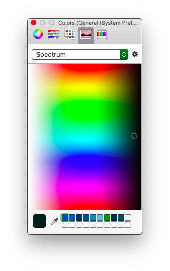

I had an Office 365 Personal subscription active on my Macbook Air since November 2019, then I decided to switch and buy the Office Home & Student 2019 version a few weeks after the expiration date.
Right after the subscription ended, I started to see the highlighting of the text in Microsoft Word really light, as you can see from the image below:
Instead of the normal colour, much darker. Everything was working fine until the subscription expired and I thought that the issue was related to the expiration of the subscription, but when I purchase and installed the Office Home & Student 2019 version nothing changed.
I tried to delete completely all files from the previous installation of MS Word, also tried to edit the colour in Preferences > Highlight colour - but nothing changed in Word.
Other apps, web browser or text editors works fine and the colour is "normal", only in Word the highlighting is too "light".
Is there a way to solve this issue?
