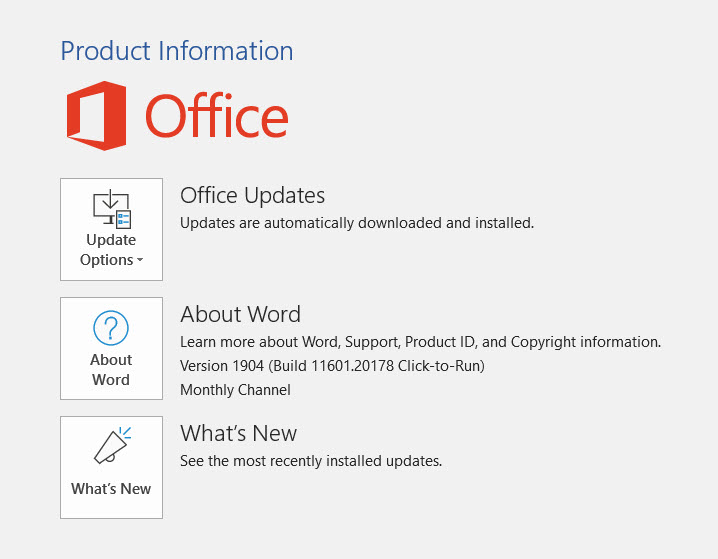

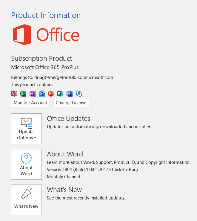

    I do notice something different about Word when it is started by running VBA code - the actual Office Product is not displayed under File Account>Product Information
    But when it is started manually, it displays

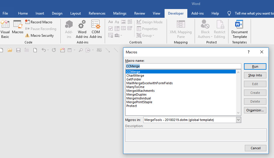

    Adding to the discussion...
    I am running a 32-bit version of Office and having no problems with the Merge Tools Add-In or the temporary one that I gave a link to.
    https://www.dropbox.com/s/0r1ltecxo8688c6/testB...
    So, it is not the 32-bit/64-bit distinction.

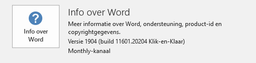

    I can confirm that ribbon customizations don't show up when Word is started using Automation, although the add-in appears to be loaded.
    I'm using Word 2019 32-bit (in Office 2019 Professional Plus) on Windows 10 Home 64-bit. Both are fully updated.
    1. Word started manually.
    2. Word started using Automation from Excel.

    This is not what I am seeing using Office 365 with the same build. They will load and operate. I will be able to try with an Office 2016 installation on Sunday.
