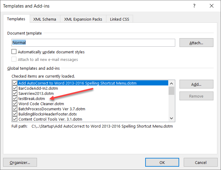

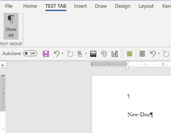

    2019-05-17T14:37:50+00:00
    I am not able to replicate here.
    • Word closed.
    • Ran my code from Excel.
    There are other Add-Ins that load earlier.
    It may be the other Add-Ins loaded first. They are loaded in alphabetical order.
    The arrow is to the one with your code.
    I am due in court and may not be back online until this evening. This weekend, I will try it on my system running 2016.

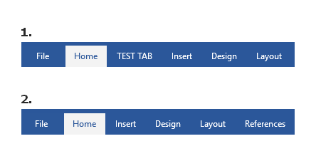

  4. HansV 462.7K Reputation points MVP Volunteer Moderator
    2019-05-17T15:28:49+00:00
    I can confirm that ribbon customizations don't show up when Word is started using Automation, although the add-in appears to be loaded.
    I'm using Word 2019 32-bit (in Office 2019 Professional Plus) on Windows 10 Home 64-bit. Both are fully updated.
    1. Word started manually.
    2. Word started using Automation from Excel.
    You can report this problem to Microsoft using File > Feedback > Send a Frown.
