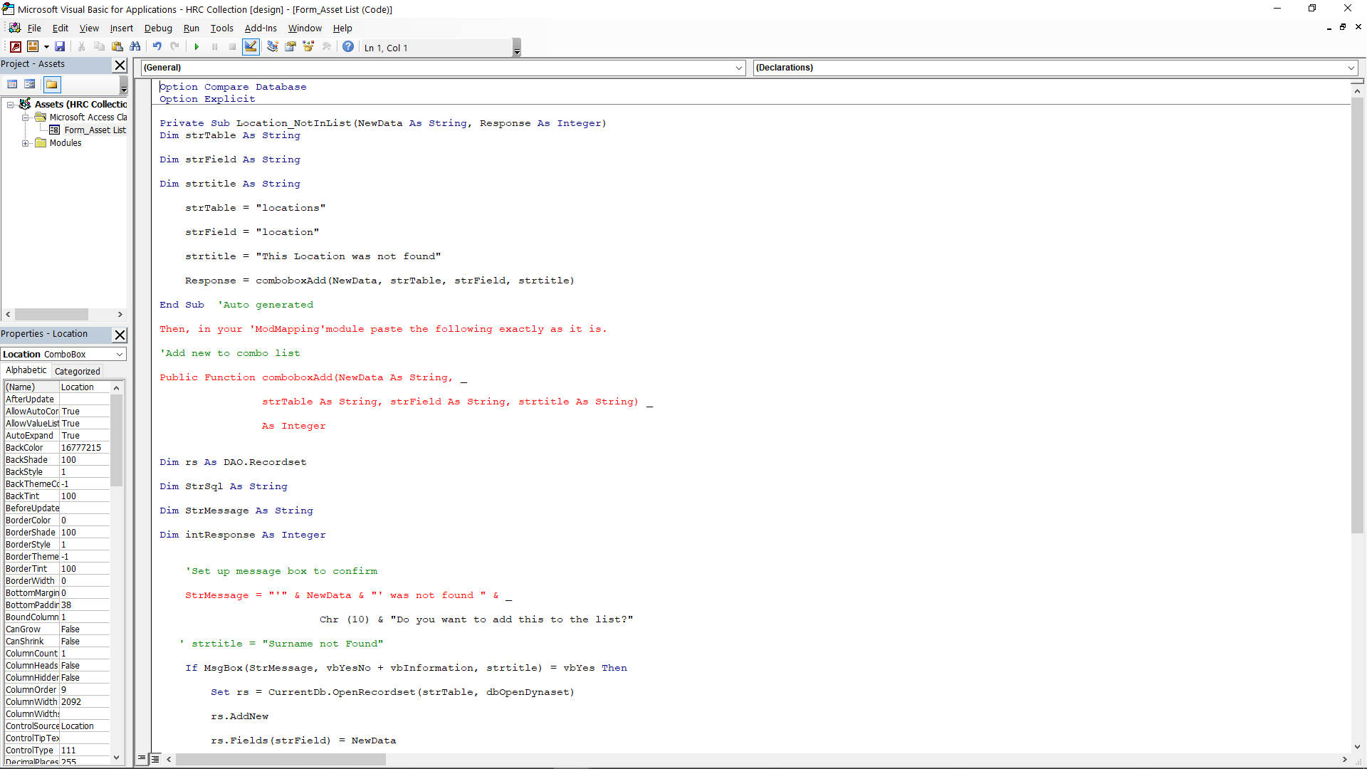

    OK SMarshall, I tried doing exactly as you said. Here are the steps I followed:
    Highlighted the locations field in my "Asset List" form. Went into "Form Design" mode. Clicked on the "event" tab in the Property Sheet. Now where it says "On Not In List" it says [Event Procedure]. I clicked on that and it opens VBA. This is what VBA now looks like:
    I then clicked on "CTRL-S" to save my database. I go back into Access, click on "New Asset" and type in the location box something that is not in there and it says "The text you entered isn't an item in the list. Select an item from the list, or enter text that matches one of the listed items".
    So I'm obviously missing something here. I think I'm following your instructions very carefully but something is still not working right.

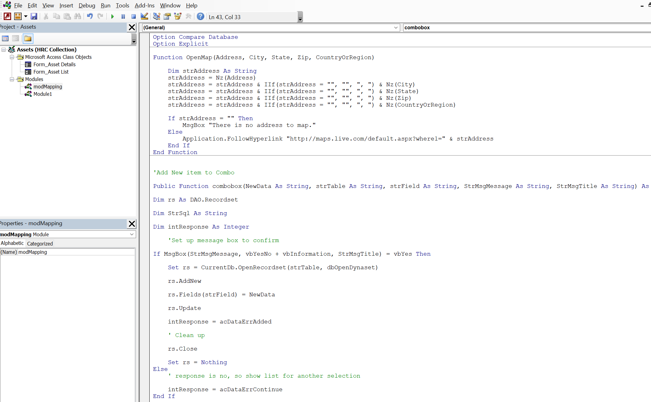

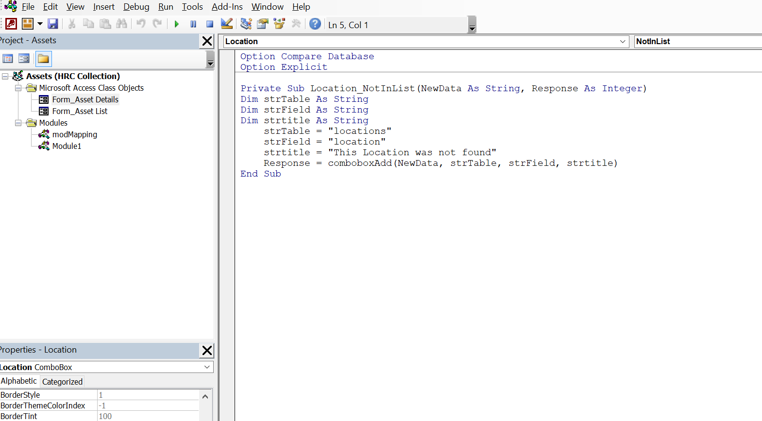

    Ok I followed your instructions exactly. Here are some screenshots to prove it:
    (Not in List)
    modMapping Module:
    modMapping continued:
    I saved this and tested adding a new location and I still get the message "the text you entered isn't an item in the list".
    Are you getting as frustrated as I am?
    Ok I think the issue is, looking at your screenshots, I added the Not in List code to the wrong form, Asset List rather than Asset Details. Let me try again because that's not the form I'm using to try to add a new record, you can't add one from there. :)

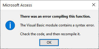

    OK tried that, now it goes to Access and shows this when I type CTRL-S to save my code changes in VBA:
    It also opened VBA which showed an error:
