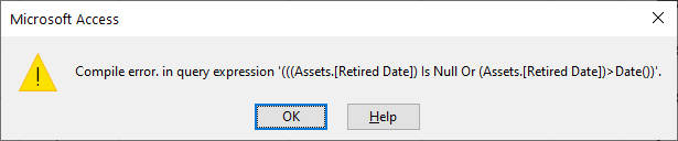

    The issues you have now are totally separate issues. If you remove the field then you also need to remove all references to it, such as that in your query.
    The previous version is called a backup... if you have not made a backup then you have a problem. I make backups many times per day and it's a good habit to get into for this very reason.
    2019-12-11T12:22:49+00:00

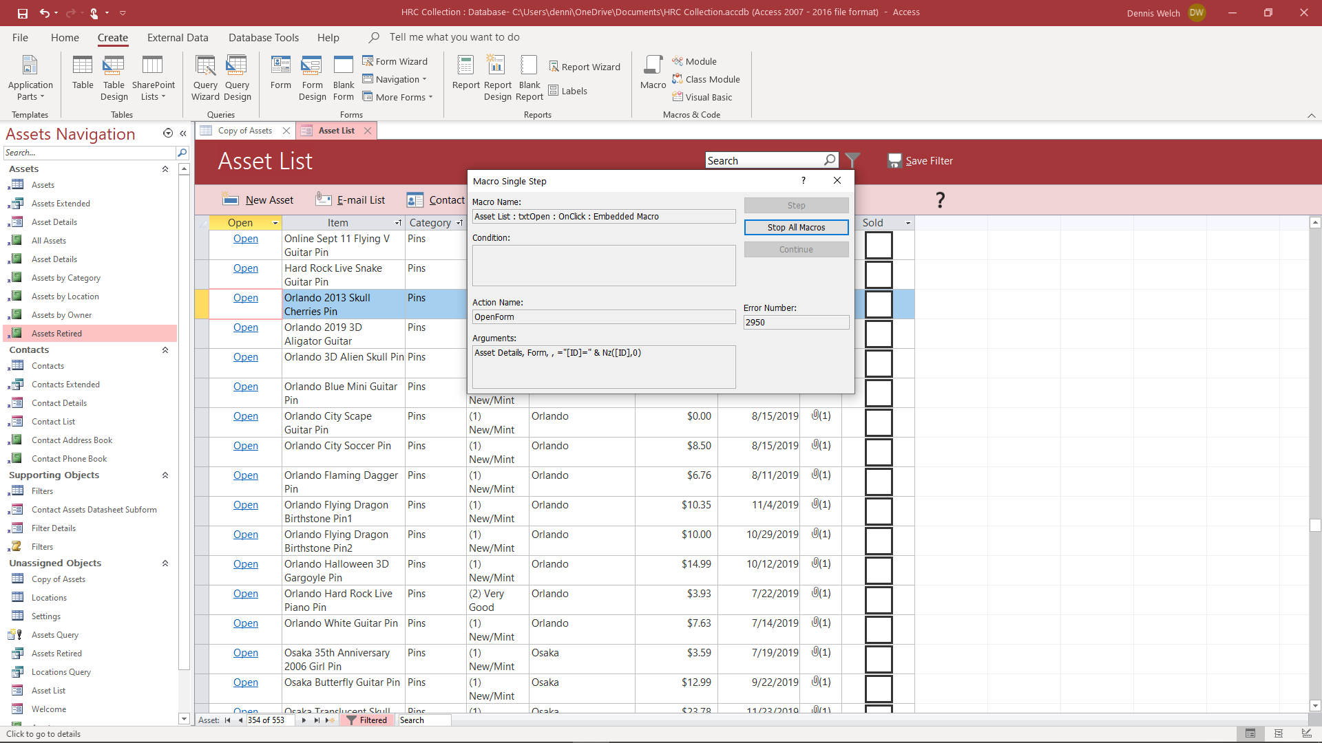

    As regards the error arising from the missing Retired Date column add the column back to the table in design view.  Having an unused column in the table won't do any harm, but hopefully should avoid the error arising again.
    For the error with the embedded macro used as the OnClick event property of the txtOpen control, try changing the macro's WhereCondition argument to a fully qualified reference to the ID column:
       "[ID] = " & [Forms]![NameOfAssetListFormGoesHere]![ID]
    I've assumed here that the ID column is a number data type.  If it's a text data type use:
       "[ID] = """ & [Forms]![NameOfAssetListFormGoesHere]![ID] & """"
