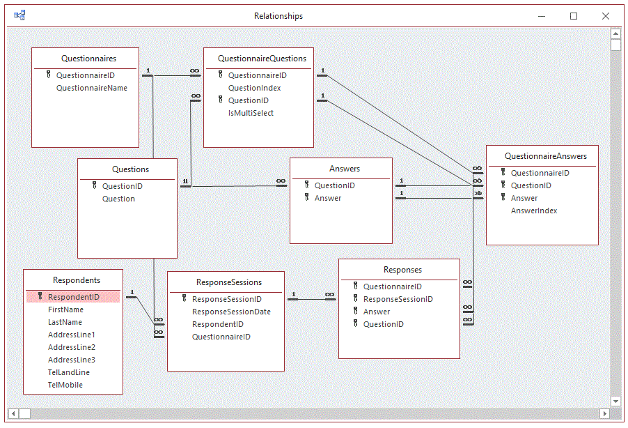

    2019-10-30T23:02:24+00:00
    The main database/survey I'm attempting to build requires 86 questions that won't fit into a single form.
    That is not how questionnaire databases are structured.  In a relational database questions and answers are each an entity type, and therefore modelled by separate tables in which each question is represented by a row in one table, and each answer by a row in another.  The relationship type between questions and answered is modelled by a further table, to which is related another table modelling the responses relationship type.  The image below is of the model for my Questionnaire demo file which you'll find in my public databases folder at:
    https://onedrive.live.com/?cid=44CC60D7FEA42912&id=44CC60D7FEA42912!169
