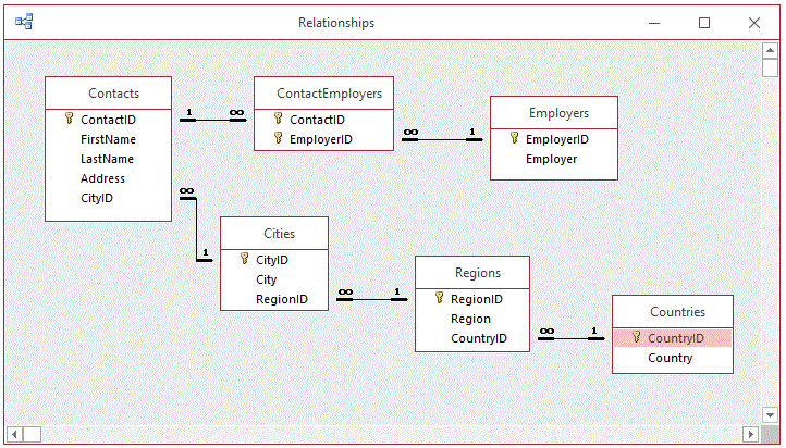

    A single non-normalized table inevitably includes significant redundancy in that each 'fact' is stated multiple times rather than only once.  This consequently leaves the table wide open to the risk of update anomalies.  Take the following simple model from my DatabaseBasics demo:
    As you can see each contact's name is stored only once, as is each city, region, country, and employer name, i.e. at the relevant column position in a row in the relevant table.  Firstly simple errors resulting from inconsistent data entry or typos are ruled out, e.g.  I once found three separate versions of my own name as author of papers in my own field of work (environmental planning), K Sheridan, K W Sheridan, and K V Sheridan.  The first two are correct, but differ; the last is a typo.  As far as the database was concerned I was three separate people.  In a correctly designed database, with an Authors table, my name would only be entered once, so such inconsistencies cannot arise.
    By enforcing referential integrity in the relationships between the tables it would only be possible for the region of Île-de-France to be in France for instance, whereas in a non-normalized database it could be shown to be in France in some rows, but incorrectly in Belgium say in others.

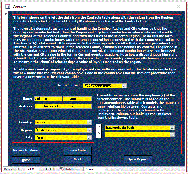

    As regards data entry all data for the above model can be entered in a contacts form within which is a single employers subform:
