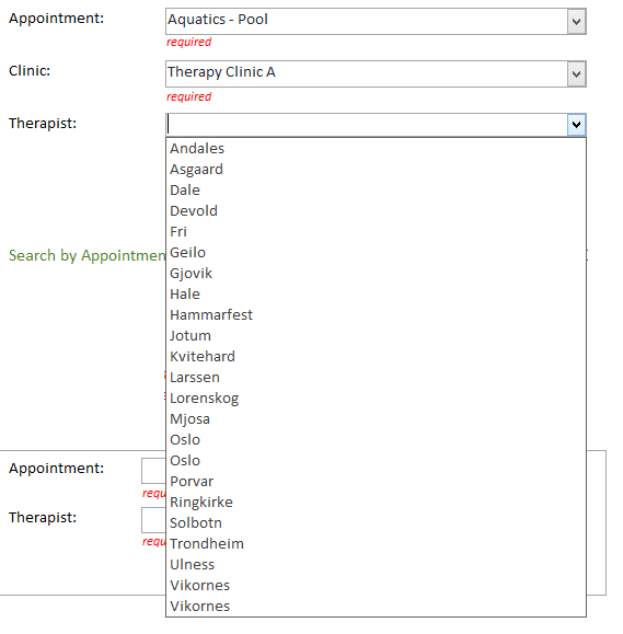

    I followed your instructions exactly, copied and pasted all the statements in very carefully. This is what I ended up with:
    The bottom search:
    The three therapists are correct, they are the only therapists that can do pool therapy.
    However when I select a name, Vigard Vikrones:
    The selection changes all by itself to a different name, Mons Mjosa
    Second issue, top search:
    Again, only three therapists can do pool therapy, as above, Mjosa, Oslo, and Vikornes.
    But when I try to do the search for pool therapy, instead of only having three therapists listed, it lists all therapists working in that clinic. It also happens with everything, such as Dry Needling, there are only four therapists that do that. Vertigo, there should only be three therapists. Cancer, there should be only two therapists, Pelvic Floor, there should be only one therapist.
    I hope I am making sense. I appreciate your time and help.
    2019-02-23T01:37:10+00:00
    Okay, this is related to the queries and I didn't test for this.  It's because the first column in the combo box must be unique and looking now at the row source queries that is not the case.
    So, I got the second one fix and sending that via eMail, no time to write out the fixes here.
    The top one is because you filter on Therapist is filtering by Clinic.  If you want it to filter by appointment you need to redo the Therapist row source.
