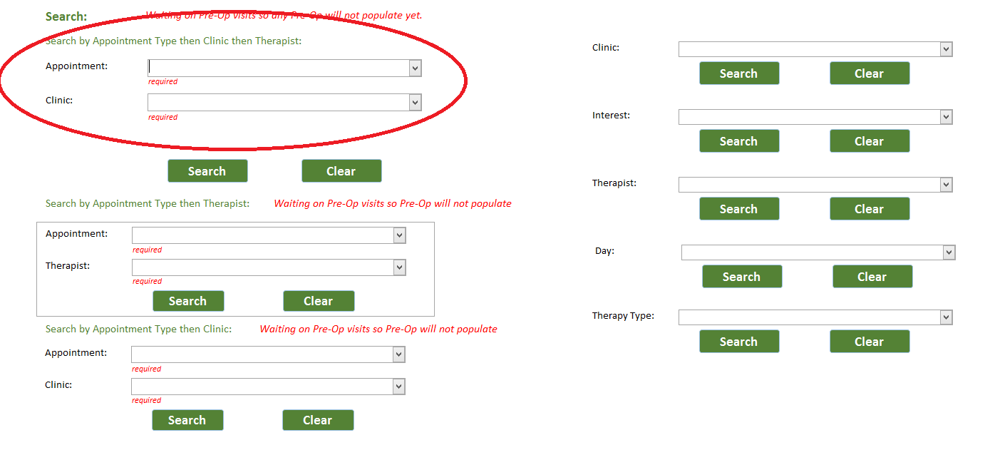

    2019-02-21T22:22:17+00:00
    Thanks Gina.
    I've made a copy as a back up and will go ahead and remove the other one. That way if management gets upset that I removed their ideas, I can quickly fix it. Hoping I get a move into IT soon as they understand a bit better than someone without an IT background.
    2019-02-21T21:26:48+00:00
    Oh, you know it is redundant.  My thoughts, leave the one that works and remove the other one UNLESS the report is different then you have to leave both and maybe indicate which report it refers to.
    2019-02-21T20:54:04+00:00
    Here is a screenshot of the current page:
    I'm not sure the red circled search (Appointment > Clinic > Therapist) is worth taking any further. It almost seems a little redundant. I am thinking of not bothering to finish it and just remove it from the page. Another option is I finish it, then remove the double search on the very bottom (Appointment > Clinic).
    Do you think it's worth finishing up the red circled area and possibly removing the bottom (Appointment > Clinic)  or just remove the top and be done with the project?
