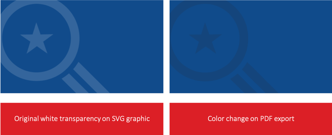

    Please HELP! More more thing, when you create a transparency in any color using any graphic format (SVG, PNG, JPG), when you export to PDF the transparency turns dark. See example below.
    2018-12-18T15:20:44+00:00
    Hi Everyone,
    Just wanted to keep you guys up to date and let you know that this issue has been reported to the related team. We do not have an ETA for a fix, but we will let you know once it is resolved.
    @Danila,
    As the SVG issue is not related to this thread, Jim has split the thread, please help us by providing the information Jim requested there so that we can check it out:
    Editable SVGs change to PNGs on SAVE
    Regards,
    Sheen
