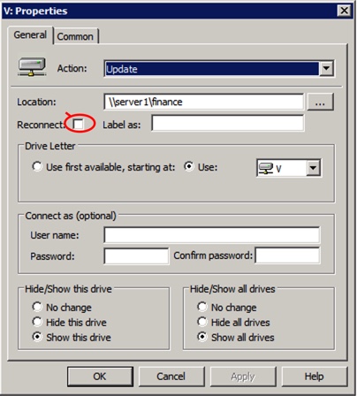

    Sorry, drive maps using GPO is as link:
    https://community.spiceworks.com/how_to/79280-mapping-network-drives-folders-via-group-policy
    2020-02-25T03:20:30+00:00
    Do you use group policy to map your network drives? If so make sure the 'Reconnect' option is unticked for each mapped drive. See attached.
    This fixed the problem for me instantly.
    Hope this helps
    Tom
