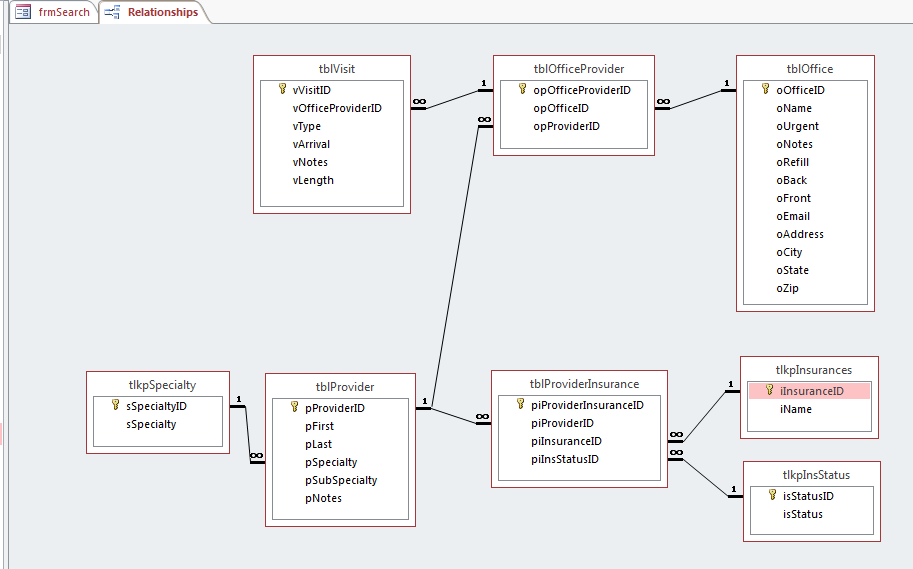

My boss asked me to do a new Access database from scratch. I’ve never done an Access database on my own before, and would appreciate any advice you guys have. This is to help employees schedule appointments for 46 medical doctors in 14 different medical offices.
As for my relationships, I hope I’ve set up everything correctly:
As you can see, I’ve set up two junction tables, but am not quite sure how to set up a search query with junction tables. I’ve looked in my two Access 2013 books, and I’ve also looked online but am not having much luck. For example, with the table Junction_Provider_Insurance, I’m not sure how to search the Junction table to pull up the doctor and if the doctor is contracted, not contracted, needs authorization or pending for the insurance. So if a doctor’s name and an insurance name such as Aetna is searched, I want the result to show that the doctor is or is not contracted with Aetna in ReportResults.

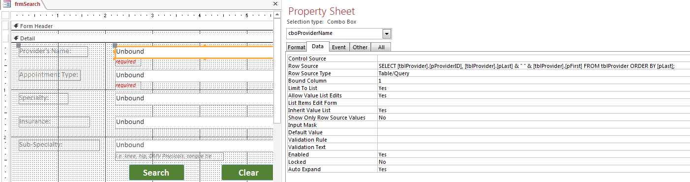

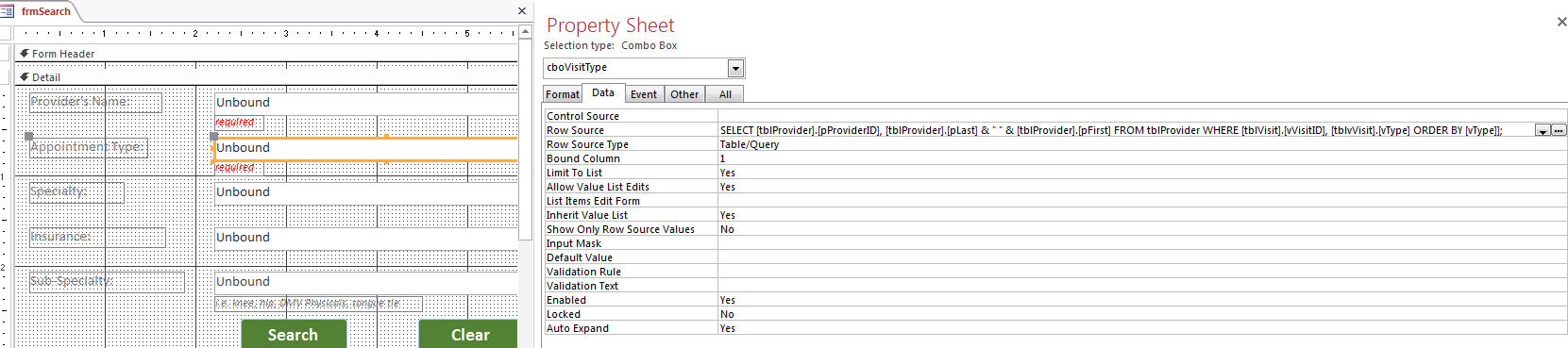

    I'm struggling with my search form. I would like for the user to select the provider's name, then the appointment box should populate based on which provider was selected.
    This is what I have so far:
    Any advice or suggestions are greatly appreciated. Thank you so much for your time and help.

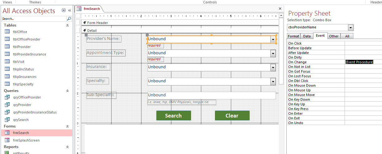

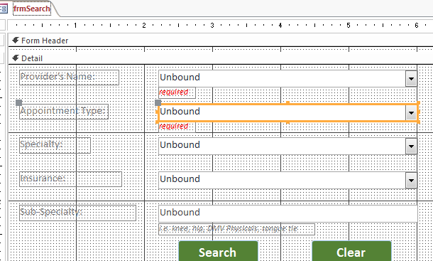

    I've tried everything following Gina's instructions. Nothing is working and I'm really frustrated.
    First cbo is ProviderName
    Second cbo is VisitType
    I want only appointments (visit type) specific to that provider to show up in the second box. I don't want ALL visits. A neurologist does not do a pediatric appointment.
    This is what I have:

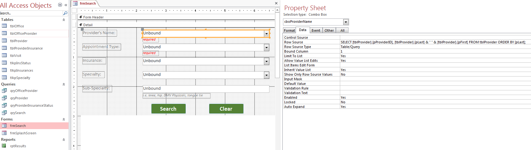

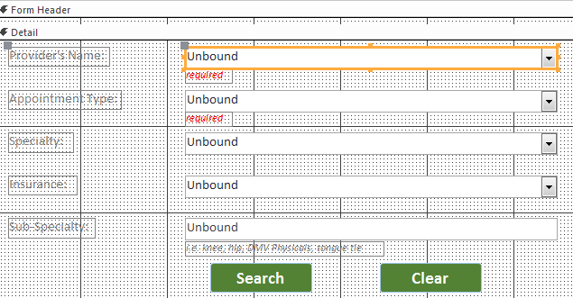

    Hi Gina,
    This is everything I have. I think I'm just really confused. I need the Provider's Name first (cboProviderName), then Appointment Type (cboVisitType), then the Insurance (cboInsurance). I just don't seem to be getting the hang of it.
