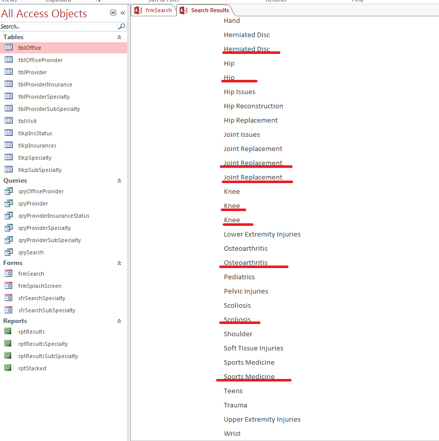

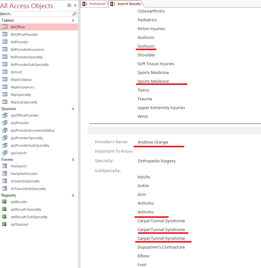

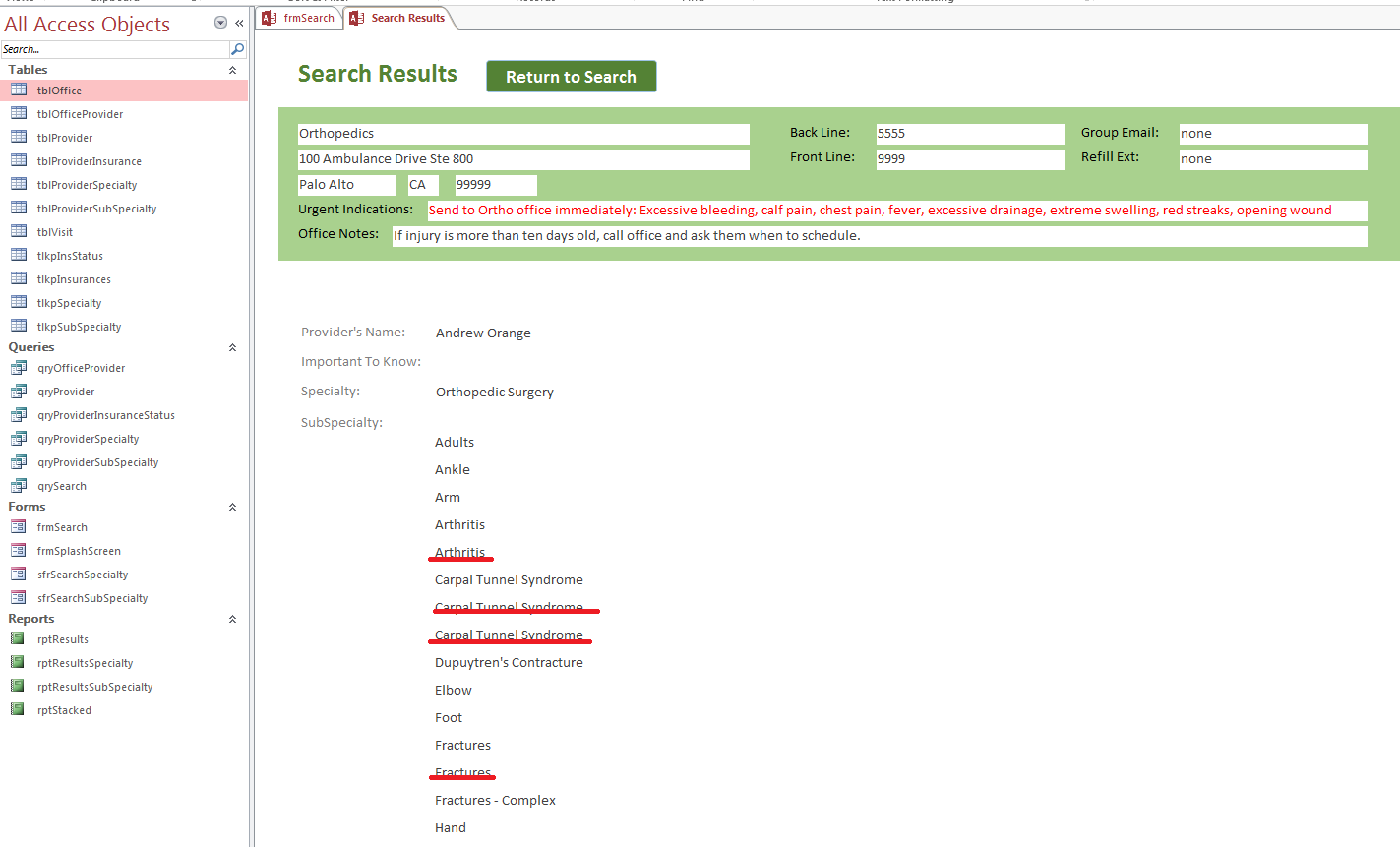

    The SubSpecialities repeats. The Specialities repeats. The same doctor repeats over 30 times on the report. So if I pull up five Orthopedic doctors, the report then repeats each doctor over 30 times for a total of over 150 times. In the third screen shot below you can see the provider repeating.

    Well, there were multiple issues...
    1. Recordsources for subreports, you need to remove all the unused tables to get rid of the duplication as that is why you are seeing duplicates, so...
    rptResultsSpecialty
    SELECT [pFirst] & " " & [pLast] AS Provider, tlkpSpecialty.sSpecialty, tblProvider.pNotes, tblProvider.pLast, tblProvider.pProviderID
    FROM tlkpSpecialty INNER JOIN (tblProvider INNER JOIN tblProviderSpecialty ON tblProvider.pProviderID = tblProviderSpecialty.psProviderID) ON tlkpSpecialty.sSpecialtyID = tblProviderSpecialty.psSpecialityID
    ORDER BY tblProvider.pLast;
    rptResultsSubSpecialty
    SELECT [pFirst] & " " & [pLast] AS Provider, tblProvider.pLast, tlkpSubSpecialty.ssName, tblProvider.pProviderID
    FROM tlkpSubSpecialty INNER JOIN (tblProvider INNER JOIN tblProviderSubSpecialty ON tblProvider.pProviderID = tblProviderSubSpecialty.pssProviderID) ON tlkpSubSpecialty.ssSubSpecialtyID = tblProviderSubSpecialty.pssSubspecialtyID
    ORDER BY tblProvider.pLast, tlkpSubSpecialty.ssName;
    1. You don't link reports on pLastName because there can be same last names.  You add pProviderID to the query and link on those.
