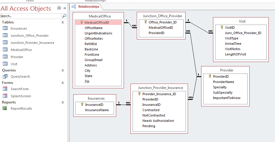

As for my relationships, I hope I’ve set up everything correctly:

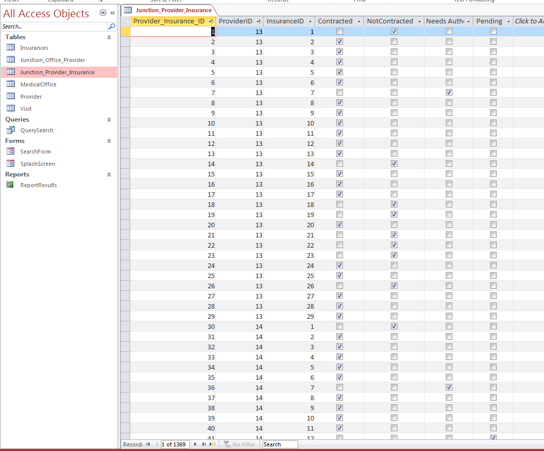

As you can see, I’ve set up two junction tables, but am not quite sure how to set up a search query with junction tables. I’ve looked in my two Access 2013 books, and I’ve also looked online but am not having much luck. For example, with the table Junction_Provider_Insurance, I’m not sure how to search the Junction table to pull up the doctor and if the doctor is contracted, not contracted, needs authorization or pending for the insurance. So if a doctor’s name and an insurance name such as Aetna is searched, I want the result to show that the doctor is or is not contracted with Aetna in ReportResults.

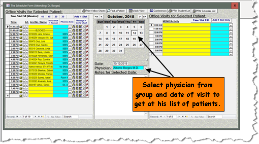

    Well, doing an EMR for a physician's office can be daunting, but the trick is to start off with a basic set of tables, forms, and reports. MS Access is an excellent relational database to do this. I've used this platform for 28 years as an oncologist and since 2009 in my Internal Medicine only office. My EMR has about 450 forms and another 450 reports. It ties together Access, Excel (for billing, sending electronic bills to Office Ally), Word, and Outlook. I love it, and still add to it about 3-4 times a week. Just start with small steps at a time...
    The most important thing is 1) to make sure that you can bill (smart to match your providers with what insurance companies that they use) and 2) make sure you can schedule patients. For the latter you need a scheduler, so make sure that you have a decent scheduling form. Eventually you can branch off into a full EMR to follow your patients electronically. In prior versions of Access there used to be a calendar.ocx control that was perfect for this but that was taken out after 2010. :( Fortunately, there are many calendar controls that you can use out there to take it's place, and some of the best ones are free. In fact, I did one back in January that has the same look and feel of the original ocx control. Instead of making a calendar form, plopping in the ocx control into it, you need to start with a calendar form and program the calendar features around the embedded control. Here is how my scheduler looks like:
    This is how this scheduler started:
    URL download:  https://app.box.com/s/z199jbpxqjcexsprthqqe1o0r8rui4e4

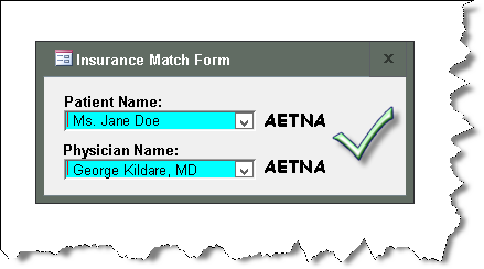

    Among your tables, you are missing a PATIENT data table (s.a. for address, phone numbers, insurance information, general notation field), a table for their MEDICATIONS, and a table for GENERAL MEDICAL INFORMATION etc.
    Going back to connecting patient with provider insurances, you can have a clickbutton on your scheduler that can popup a simple form that shows if a match occurs:

    You are off to a good start.  Let's not worry about the Forms or the queries until we get a wee bit more work on those tables.  Have a look at...
    https://www.access-diva.com/dm20.html
    I realize the above is not for a doctor's office but it is for appointments.  I will also add a few observations...
    1. No need to put the word *Junction* in your Table Names.  You really want to keep those table names as short as possible... you'll thank me later.
    2. Remove the underscores, awkward to type and later on you'll be kicking yourself for adding them.
    3. Adapt a Naming Convention and stick to it.  Have a look at...
    https://www.access-diva.com/d1.html
    1. BIT field (Yes\No) can be handy but let's use those sparingly as they are a real pain if you ever think you might to upsize to SQL Server.
