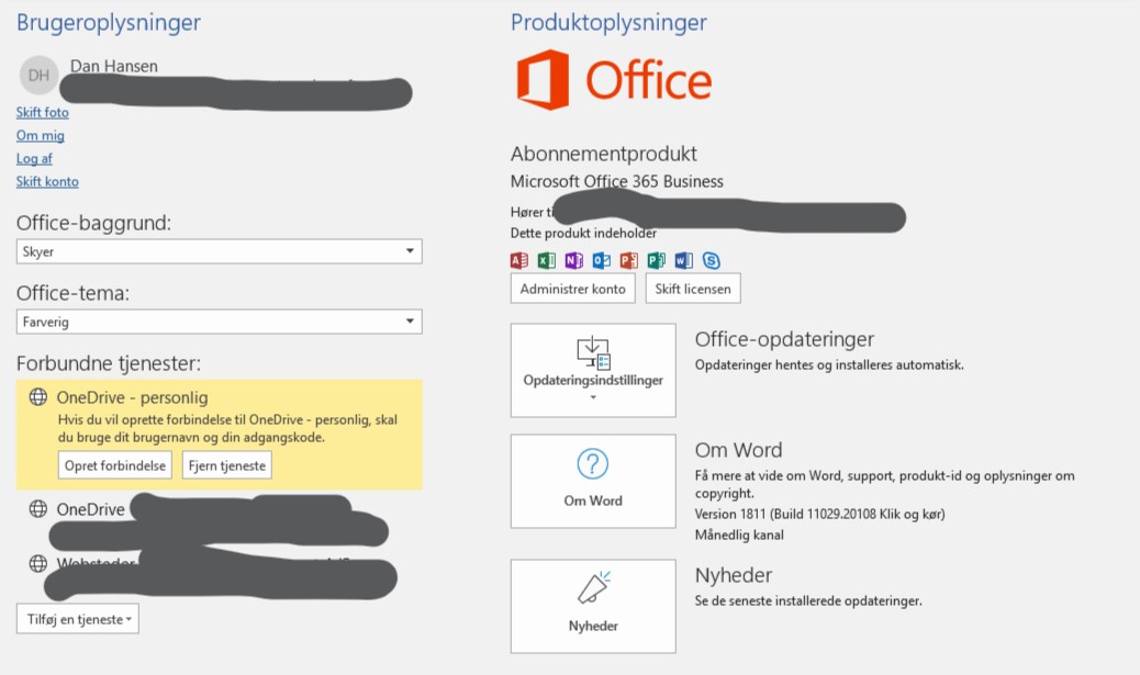

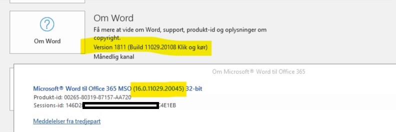

    But when checking version number I found something that I found weird.
    When pressen "about word" the build number is not the same (11029.20108 / 11029.20045)
    Complete version page:

    Using Windows 10 Pro - (Version 1809 – OS build: 17763.195) - fully updated.
