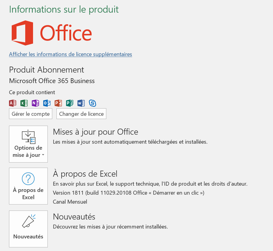

    2018-12-20T17:16:45+00:00
    @Bruce,
    Thanks for sharing the crash logs with us. Could you also share a screenshot of Product information about your Office? We appreciate your help.
    Regards,
    Tina
    Hi Tina,
    here you are, thanks for your help :
    2018-12-20T17:37:56+00:00
