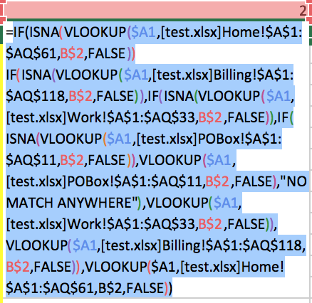

The following is a screenshot of the error - it seems that the part in red might be contributing. Are you able to determine anything from the screenshot?

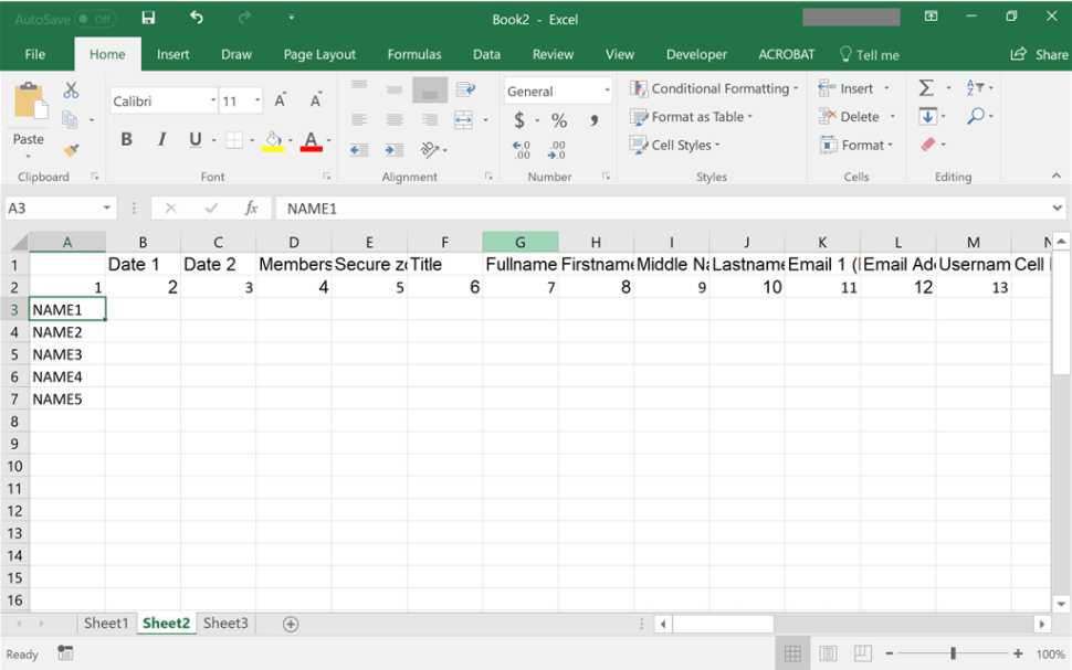

did you setup your names sheet this way?
where there are numbers below the heading names that replaces that reference with the actual column numbers? or you can manually type the column numbers to 44 cells in all instances to each formula
what is going to happen if you manually replaced all those red things with the actual column numbers would be if you pasted that formula in b3, you would put the number 2 to replace the red ones on that cell in all 44 cells before you can copy the formula down to all the cells adjacent to the names then when you paste it in C3 you would replace the red things with the number 3 and so on till you've done all 44 cells across the spreadsheet
Yes I set the name sheet that way but the name of the sheet is called "names only" - not "names". I'm sorry but I don't understand your explanation. All I can say is that I set it up as you suggested and I pasted in the formula at B3 and got the error. I'm not able to share the file at this time. Maybe I need to come back to this later on and see if I can re-read and understand it.
