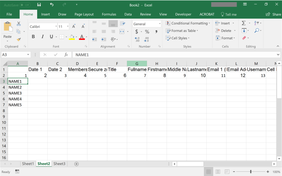

    and that blank worksheet with the names in it we will be formatting into something that looks like this:
    see those numbers below the heading labels?
    we will use them to reference the column numbers into the formula and paste the formula into each of the cells to populate all of them, then we will copy all the populated cells, and paste them as value.

    first make sure the POBox sheet has no space between them.
    the names sheet heading put the numbers below them starting with the name at Column A as 1 all the way to Column AS.
    HERE IS THE FORMULA:
    IF(ISNA(VLOOKUP($A1,[test.xlsx]Home!$A1:$AS$61,1,FALSE))
    IF(ISNA(VLOOKUP($A1,[test.xlsx]Billing!$A$1:$AS$118,1,FALSE)),IF(ISNA(VLOOKUP($A1,[test.xlsx]Work!$A$1:$AS$33,1,FALSE)),IF(ISNA(VLOOKUP($A1,[test.xlsx]POBox!$A$1:$AS$11,1,FALSE)),VLOOKUP($A1,[test.xlsx]POBox!$A$1:$AS$11,1,FALSE),"NO MATCH ANYWHERE"),VLOOKUP($A1,[test.xlsx]Work!$A$1:$AS$33,1,FALSE)),VLOOKUP($A1,[test.xlsx]Billing!$A$1:$AS$118,1,FALSE)),VLOOKUP($A1,[test.xlsx]Home!$A$1:$AS$61,1,FALSE))
    EDIT the number 1 before the FALSE, replace it with the reference cell with the number above it.
    so if you paste the formula in cell B3, replace the number 1 with $B$2
    then test the first name to see how it behaves.
    if it behaves accordingly, then copy it and paste it into the entire worksheet.
