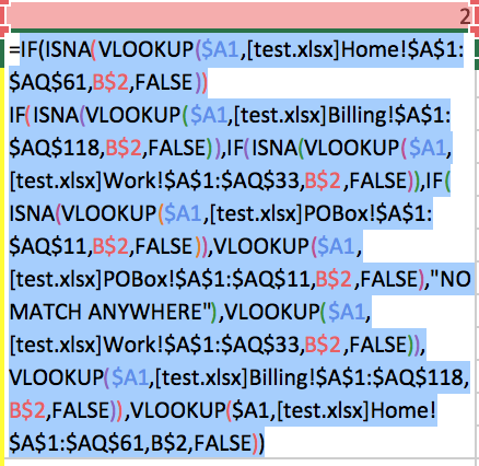

    Sorry the screenshot below shows what it looks like in B3 but when I click enter, it gives me the error again.
    2017-10-22T06:10:40+00:00
    Ok I tried that one and I still got the error. The following are the screenshots of the formulas in the cells - B3 and C3:
    2017-10-22T06:02:35+00:00
    let's test one using this formula:
    paste this in B3:
    =IF(ISNA(VLOOKUP($A1,[test.xlsx]Home!$A$1:$AQ$61,2,FALSE))
    IF(ISNA(VLOOKUP($A1,[test.xlsx]Billing!$A$1:$AQ$118,2,FALSE)),IF(ISNA(VLOOKUP($A1,[test.xlsx]Work!$A$1:$AQ$33,2,FALSE)),IF(ISNA(VLOOKUP($A1,[test.xlsx]POBox!$A$1:$AQ$11,2,FALSE)),VLOOKUP($A1,[test.xlsx]POBox!$A$1:$AQ$11,2,FALSE),"NO MATCH ANYWHERE"),VLOOKUP($A1,[test.xlsx]Work!$A$1:$AQ$33,2,FALSE)),VLOOKUP($A1,[test.xlsx]Billing!$A$1:$AQ$118,2,FALSE)),VLOOKUP($A1,[test.xlsx]Home!$A$1:$AQ$61,2,FALSE))
    paste this in C3:
    IF(ISNA(VLOOKUP($A1,[test.xlsx]Home!$A$1:$AQ$61,3,FALSE))
    IF(ISNA(VLOOKUP($A1,[test.xlsx]Billing!$A$1:$AQ$118,3,FALSE)),IF(ISNA(VLOOKUP($A1,[test.xlsx]Work!$A$1:$AQ$33,3,FALSE)),IF(ISNA(VLOOKUP($A1,[test.xlsx]POBox!$A$1:$AQ$11,3,FALSE)),VLOOKUP($A1,[test.xlsx]POBox!$A$1:$AQ$11,3,FALSE),"NO MATCH ANYWHERE"),VLOOKUP($A1,[test.xlsx]Work!$A$1:$AQ$33,3,FALSE)),VLOOKUP($A1,[test.xlsx]Billing!$A$1:$AQ$118,3,FALSE)),VLOOKUP($A1,[test.xlsx]Home!$A$1:$AQ$61,3,FALSE))

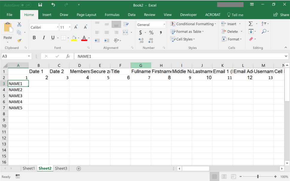

    did you setup your names sheet this way?
    where there are numbers below the heading names that replaces that reference with the actual column numbers?  or you can manually type the column numbers to 44 cells in all instances to each formula
    what is going to happen if you manually replaced all those red things with the actual column numbers would be if you pasted that formula in b3, you would put the number 2 to replace the red ones on that cell in all 44 cells before you can copy the formula down to all the cells adjacent to the names then when you paste it in C3 you would replace the red things with the number 3 and so on till you've done all 44 cells across the spreadsheet
