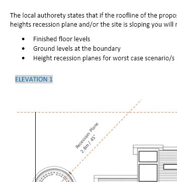

    2018-07-13T01:06:02+00:00
    Hmmm..that does nothing at all! You have to clear the formatting for it to pick up a spelling mistake.
    I purposely spelt authority wrong here and as you can see doing your steps does nothing, but it will work again with a red squiggle if I clear formatting. Can you explain what is going on so others can be helped please.
