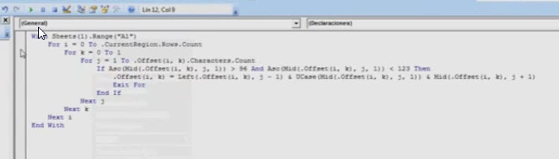

In that case, use:
With Sheets(1).Range("A1")
    For i = 0 To .CurrentRegion.Rows.Count
        For k = 0 To 1
            For j = 1 To .Offset(i, k).Characters.Count
                If IsNumeric(Left(.Offset(i, k), 1)) Then
                    GoTo Nextj
                End If
                If Asc(Left(.Offset(i, k), 1)) > 64 And Asc(Left(.Offset(i, k), 1)) < 90 Then
                    GoTo Nextj
                End If
                If Asc(Mid(.Offset(i, k), j, 1)) > 96 And Asc(Mid(.Offset(i, k), j, 1)) < 123 Then
                    .Offset(i, k) = Left(.Offset(i, k), j - 1) & UCase(Mid(.Offset(i, k), j, 1)) & Mid(.Offset(i, k), j + 1)
                    Exit For
                End If
Nextj:
            Next j
        Next k
     Next i
End With
