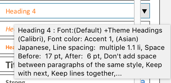

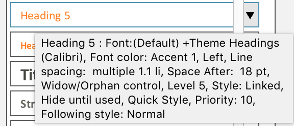

    THESE TWO SCREENSHOTS SHOW THE DIFFERENCE BETWEEN THE STYLE SPECIFICATIONS FOR THE ORIGINAL HEADING 4 AND THE NEW HEADING 5 THAT IS BASED ON HEADING 4.  SOME OF THE DIFFERENCES (E.G., FON'T COLOR) ARE BECAUSE THE NEW HEADING 5 IS BASED ON "NO STYLE", WHILE THE ORIGINAL HEADING 4 WAS BASED ON "NORMAL".  BUT THE CHANGE IN SPACING DOESN'T SEEM TO HAVE ANYTHING TO DO WITH THAT.
    ORIGINAL HEADING 4:
    NEW HEADING 5, BASED ON ORIGINAL HEADING 4:

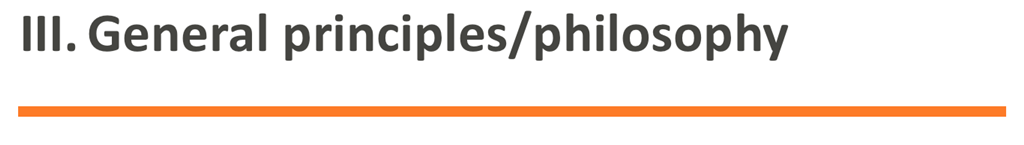

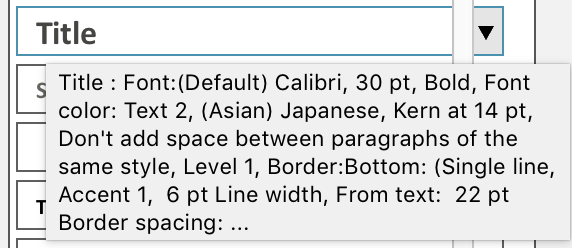

    STYLE SPECS FOR ORIGINAL TITLE STYLE:
    APPEARANCE OF ORIGINAL TITLE STYLE (except that I've added chapter numbering):
    STYLE SPECS FOR NEW HEADING 1, BASED ON TITLE STYLE (w/o chapter numbering):

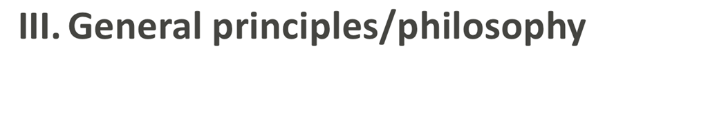

    BUT: APPEARANCE OF NEW HEADING 1, IF I SELECT "BASED ON–>NO STYLE" [NOTE I LOSE THE ORANGE LINE]
