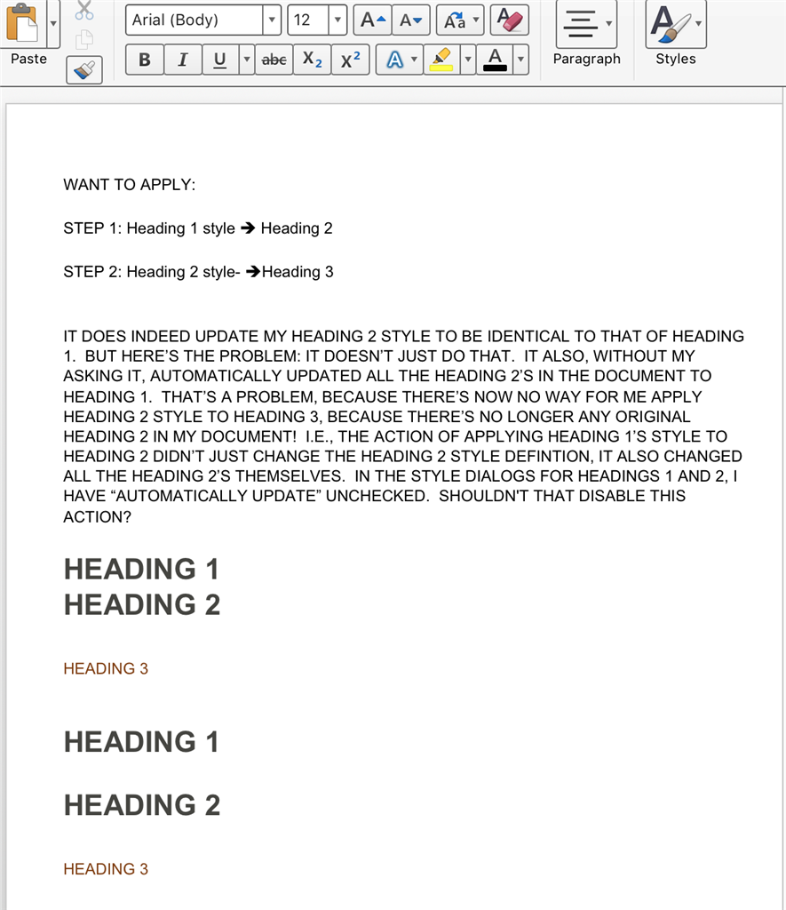

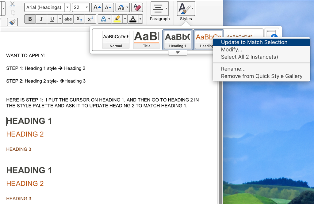

    Here are two annotated screenshots.  I get the same behavior Doug shows in his post. That's fine for updating a single heading, but I'm running into trouble because I'm trying to update more than just one Heading level:
    HERE IS STEP 1:  APPLY HEADING 1'S STYLE TO HEADING 2:
    IT WORKED, BUT IN A WAY THAT PREVENTS ME FROM BEING ABLE TO DO STEP 2, WHICH IS TO APPLY HEADING 2'S STYLE TO HEADING 3 [It didn't just update the style definition for Heading 2, it also updated every Heading 2 in the document itself.  As a result, there's no longer any original Heading 2 style in my document that I can apply to Heading 3.  I've got "Automatically Update" unchecked, which I assumed would prevent this action, but apparently "Automatically Update" refers to something else.  I checked Word's documentation but wasn't able to find any info. about its function.] [You can't get around this by creating a new style based on Heading 2 and saving it under a different name, because any Heading that is based on Heading 2 will also be converted to Heading 1's style.]:

    2017-03-01T22:37:19+00:00
    Maybe it's a Mac problem?  (It would not be the first)
    However in Windows versions of Word, if I insert a Heading 1 style paragraph and the change the font to Red and then use the Update Heading 1 to Match Selection
    that is what happens
    Further, if I change the style applied to the text to Heading 2
    and then use the "Update Heading 1 to Match Selection"
    that is also what happens
