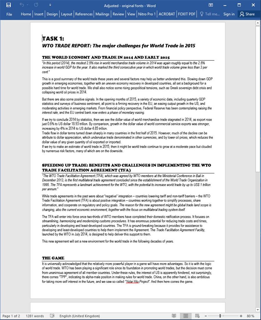

IMAGE 1
The following is picture shows page 1 of my document in "Print Layout"-view. This is how I want the document to look when printed.
IMAGE 2
Here is a picture of the Print-preview menu. You can see that the Print preview still shows the document exactly as I want it. No problems. No funny settings selected. No "Print Markup" selected.

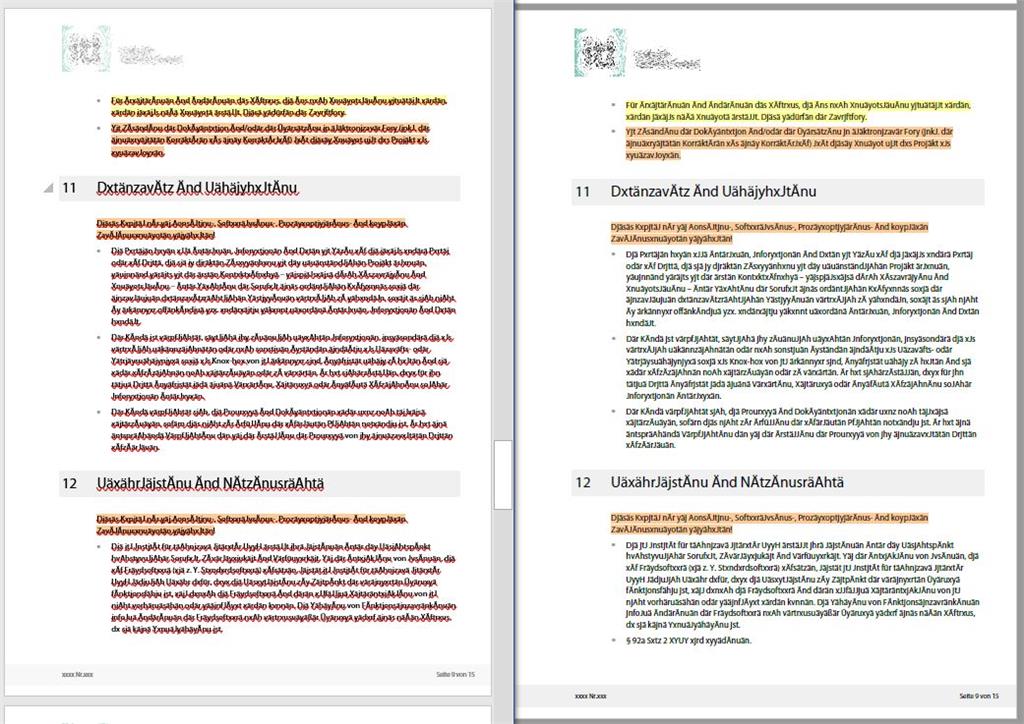

    I used the files I sent to him in this fresh installation, but unfortunately*,* this is what happened:
    1. Opening the .docx (with the embedded fonts)
    • From the screenshot below, you will see that Word 2016 has failed to display and use some of the embedded fonts correctly. (Strange...., since it is only 2 font family types!?)
    • There were no error messages, just the substitution of the fonts with whatever Word 2016 decided.
    • The font names remained as the custom ones I used.
    FINAL OUTPUT (PRINTING): The margins / page breaks printed correctly to the PDF, but with the wrong fonts!
    = I am therefore no closer to a solution.
