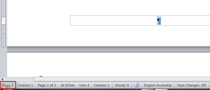

    When the selection is in the Envelope, the status bar at the bottom of the screen displays Page 0
    Also, if you were to add a Page number field to the Envelope, you would see that it displays 0 as the page number.

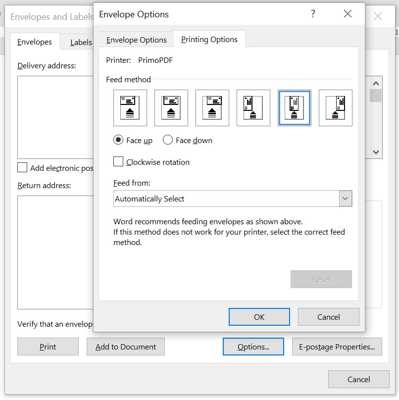

    When you say that you have "been through all the setting and adjustments", did that include those available via the Options>Printing Options in the Envelopes and Labels dialog?

    Try using the Clockwise Rotation facility in the Envelope>Options>Printing Options dialog.
    It could also be that you need an updated driver for the printer that you are using.
