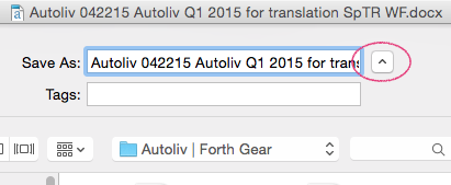

2015-04-25T21:42:16+00:00
How about clicking twice in this button?
