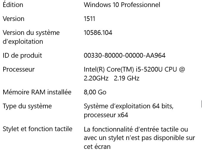

    2015-12-20T05:17:31+00:00
    This thread really interests me as I've battling the same issue. Only difference is, my OS is 64bit and Office365 is 32bit.
