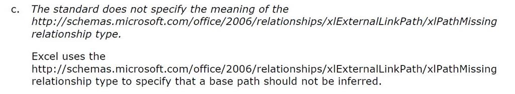

    I think the problem will show up when some user action changes this setting which I found in
    [MS-OE376]:
    Office Implementation Information for ECMA-376 Standards Support
    Examples of such changes could be:
    • sharing the workbook with a user who has a different version of excel
    • changing the Document Inspector settings default
    • changing the Document Inspector settings before sharing the document
    • switching versions of excel yourself
    • saving the spreadsheet as a different version format to share
    • etc.
    I haven't checked if these all cause the problem, but its probably the reason the problem is somewhat random.
    As a minimum it looks like Microsoft should provide a warning of this setting on saving as to its effects and give the user a way to make the setting be what they need.

    The link was referenced previously, but it also goes into more detail on the cause. Basically Microsoft stores hidden XML data in the spreadsheet with pivot tables. For some reason an XML property
    //schemas.microsoft.com/office/2006/relationships/xlExternalLinkPath/xlPathMissing
    Sets some external reference to something even though the spreadsheet has no external references. This seems to cause the spreadsheet to then embed the reference to the original file when it is saved as a different file name or renamed or moved.
