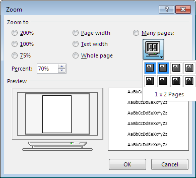

    You can get a two-page spread in Word 2013 by clicking on Zoom in the Zoom group on the View tab. Then click the arrow beside Many pages and choose 1 x 2 Pages as shown below.
    This approach with Word 2013 produces the following page order and layout with a gap between two pages in the centre. This could be good for viewing but not for Press Dummy which I will discuss later in this post.
